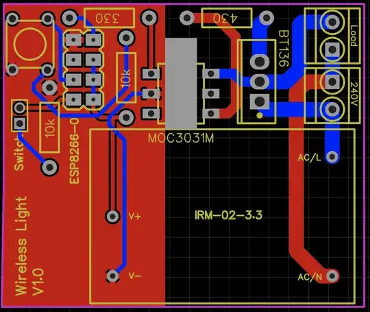

I was wondering if I could get some critique on my first PCB layout.
I've tried to isolate the 240V side from the 3.3V side as best as I can.
Only thing really concerning me is if I there is enough distance between my tracks on the 240V side and if the track widths are enough?
I am trying to keep the PCB as compact as possible. At the moment it measures about 46mmx39mm.

UPDATED PCB:
Updated PCB

    (1) What's the grey box under the MOC? (2) Usually we'd put the component designators (R1, etc.) on the PCB rather than the component values. (3) R2 is compromising the creepage distance unnecessarily. Move it to the right. (4) The ground pour around the opto pins also reduces the creepage distance. Is it required? – Transistor Sep 23 '18 at 20:12
  • @Transistor 1) The grey box is a cutout of the PCB board for isolation. 2) I'll add the designators instead. 3) Is 3.5mm enough distance? 4) No, not required I can remove it if necessary. Have updated the PCB in the original post at the bottom. – Tenatious Sep 23 '18 at 20:17
    a 2mm cutout extending past AC ~DC nodes is done to protect against 3kV transients using 1.5kV /mm for air – Tony Stewart EE75 Sep 23 '18 at 20:25
  • How is the ESP-01 module physically positioned over the board? Does it hang off to the left (off the board) or the right (over the optocoupler)? –  Sep 23 '18 at 20:43
  • @duskwuff Over the optocoupler – Tenatious Sep 23 '18 at 20:50
  • Do you meet the creepage requirements between R1 and R2? Same for the pins of incoming 240 V, what’s the creepage between the pads? – winny Sep 23 '18 at 21:01
  • @winny I've modified it a little bit from comments so it is 3.1mm between R1 and R2 with a slot gap in there as well. The distance between the pads of the screwed terminal are 1.5mm – Tenatious Sep 23 '18 at 21:03
  • That’s too low for pollution degree II and material group 3. What’s the CTI for the PCB? – winny Sep 23 '18 at 21:07
  • @winny Can't actually see any data on their site. Was going to get it done at https://jlcpcb.com/capabilities/Capabilities – Tenatious Sep 23 '18 at 21:12
  • Ask or assume CTI=175 (material group 3). – winny Sep 24 '18 at 08:02

Allowing the ESP8266 module to overhang the optoisolator violates the isolation boundary. Consider rotating the module so that it overhangs the (currently unused) space on the left of the board.
Using surface-mount resistors for pullups will save you a considerable amount of board space. (The thru-hole resistor on the HV side is fine.)
You only need to use thick traces for nets that will be carrying a lot of current. You can safely use thinner traces for the optocoupler and the voltage regulator, as neither of these should be carrying a lot of current.
Rotating the BT136 180° may allow you to move the optocoupler up and the resistor down, saving some trace length.
Adding a fuse on the line input might be a good idea.

Your questions seem to be: Is the slit enough isolation? Are the tracks separated enough? Are the tracks substantial enough?
First, there is not an apparent safety ground on the board. If you're using line voltages, neutral cannot be counted on to be ground. You seem to have a push button on this board, but no Earth ground at all. I'm all for experimentation, but this made me create a stackexchange account just to respond to-please fix this.
Your line and load connector selection is looking like it's going to be the limiting factor in how much separation you can get. Also consider your thru-hole leads- I can't tell whether components are mounted on the red or blue side. Consider also the addition of solder when checking your separations. Check your board material and thickness for voltage rating also.
Regarding trace widths, you have to calculate that based on load current drawn and copper thickness (weight) on the PCB.
I would recommend you research how much separation is actually needed, use a PCB software package that has conductor to conductor separation design rules, and set them to that value, so you can determine if you have any violations. Add safety ground, and please be careful.

  • I’ve actually removed the push button already as it isn’t needed on the final PCB. The whole thing will be in an enclosure and so not touchable once installed. I could use a different live and load connector. These were just the first ones I came across. The board material is FR-4 and 1.6mm. Do you have any recommended PCB design software as I was using a free software that doesn’t offer that functionality. – Tenatious Sep 25 '18 at 19:23

  • Ok - just didn't want you to have a hot enclosure or button. It looks like you have 1.5-2mm btw connector pads, which might not handle that voltage. That sounds like it should be a thick enough board - [link](https://electronics.stackexchange.com/questions/211025/high-voltage-multilayer-pcb)'see also'. One tool that's free and seems to have trace-trace DRC rules is PCB123 from one of the PCB mfrs, but iirc they might try to lock you in to their board house. There's also Eagle, which seems to now offer monthly licenses. (Apologies if I'm not supposed to mention products - I'm new here). – user199452 Sep 25 '18 at 20:38
Normally a board house can do slot cuts as narrow as 31 mils or 2mm. Your slot cut need not be wider than that, but it should extend to the purple line which I assume is your 50 mil perimeter clearance.
This way you isolate R2 from R1 in terms of creapage. 240 VAC is not that high, but even with 600 VAC (Canada) a slot cut kills any chance of creapage or creapage plus arcing.
Taken to extremes you could insert thin sheets of mica into the slots in case the triac or SCR blows in a violent way. Mica will stop plasma-hot debris for a second or so, time for an upstream fuse to blow.
You could stop the slot cut just past the R2 annular ring. Slot cuts can go past the edge of a board but it looks tacky unless a robust isolation barrier is needed.
Note that all slot cuts have rounded corners equal to the radius of the bit doing the cut. Since you need to give precise dimensions to the board house do not confuse them with square corners as they cannot make them. For slot cut dimensions give them the length and width minus the radius of the bit they use. For 2mm bits decrease documented dimensions by 1mm, etc.
  • The purple line is the PCB edge. I can extend the slot cut in between R1 and R2 – Tenatious Sep 23 '18 at 20:42
  • You could stop the slot cut just past the R2 annular ring. Slot cuts *can* go past the edge of a board but it looks tacky unless a robust isolation barrier is needed. –  Sep 23 '18 at 20:47
  • Yeah I've done that now. Left just a little gap at the edge of the board but extended it past the R2 pad. :) Thanks – Tenatious Sep 23 '18 at 20:48
  • If that purple line is your board edge and you're using Altium, you need to set it. Select the board edge lines and then go to (I think) Edit->Board Shape->Define from Selected Objects – Daniel Sep 23 '18 at 21:09
  • @Daniel It was done in EasyEDA. – Tenatious Sep 23 '18 at 21:14
  • @Tenatious. I added that slot cut to my answer as comments are not always archived but questions and checked/accepted answers are. –  Sep 23 '18 at 21:21
  • @Tenatious. If your grid size is 100 mils then you have some tiny holes there! Daniel noticed some important things. –  Sep 23 '18 at 21:26

I don't know what your part looks like with that ESP8266 footprint, but the holes are TINY.
Typically on a DIP part, pin 1 is square and the others are circular or stretched circular
R3 and switch pad (U2?) are too close together IMO. If you solder waved this there is a decent chance of bridging and it can be just annoying to have leads that close that aren't connected.
Typically ICs are designated "U". Switches/buttons are "SW" "S" "PB".

  • You're right, I hadn't even noticed how small the holes had ended up. That was me messing around removing the outline of the ESP-01 as it was a bit too much on the silkscreen. Yeah you're probably right about R3 and the switch. Will alter that slightly. – Tenatious Sep 23 '18 at 21:22
