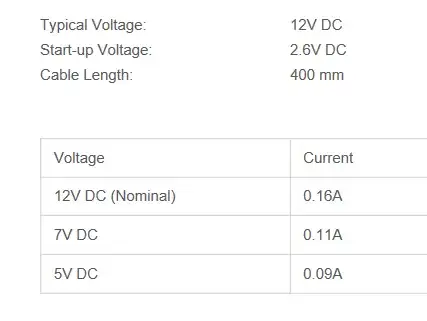

Alternatively, I thought about just using rechargeable D cell batteries. The fan's max draw is 12V at 0.16A. Which is 1.92W each, assuming max load which I am. If I have 4 fans running while I'm sleeping, and let's assume a 10hr sleep, that is 76.8Wh or 6.4Ah at 12V.

The Fans you have selected are quite reasonable: you can find more data on them here.
Arctic characterize the fans this way:

  1. Since you'd like to speed control the fans you need a speed controller. I'd suggest that you DO NOT get a PWM speed controller as some BLDC fans may operate poorly using these. Notice here in the Arctic data they simply point out the operation of the fan at several DC voltages. Since you've pointed to a 3-pin fan you might be able to use a computer style PWM controller, but you need to get one that always starts the fan on a high voltage and then reduces it. Otherwise if you turn the unit on and the speed is set low, there is a chance the fan will stall.
    The fans you've selected have an amazingly low start voltage (2.6V) so maybe you'd be OK, but I would be nervous.

As you can see from the Arctic data on the F8, you don't need to change the supply voltage (which is what the high powered 3 wire PWMs do) and can still reduce the speed and the power consumption.

BLDC Fans are pretty cool, pun intended. The load current rises with voltage so they have like a resistive load with some ripple current.
Thus any power calculations must be adjusted for actual voltage used. 12.5/12*76.8W =80W...leading to
