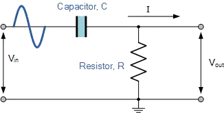

When the impedance of the capacitor equals that of a load resistor, the gain of the circuit is 70.71% i.e. an attenuation of 3 dB. For the load resistor this means: -
  • Bias resistors connected to power rails are to be regarded as being in parallel
  • Base current equivalent resistance is in parallel to bias resistors
If you go lower in frequency, the attenuation is more and if you go higher in frequency then gain approaches unity. So, set a cut-off frequency where an attenuation of 3 dB is of no-consequence to the performance you wish to obtain.

Your calculations are not that bad. Both of your capacitors form a High-pass filter. So, they decide about the lowest frequency you amplifier can amplify.
And we can find the pole frequency (corner frequency) for each capacitor separately.
All we need is to ask our-self one simple question: What resistance is seen by the capacitor?
The \$C_1\$ capacitor sees \$R_{IN}\$ and \$R_{sign}\$ (signal source resistance) in series.
And \$C_2\$ capacitor, on the other hand, sees Rc and RL in a series.
Therefore
$$F_1 = \frac{1}{2\pi C_1 \left(R_1||R_2||\right(r_{\pi} + (\beta+1)R_E))}$$ I omitted Rsig
$$F_2 = \frac{1}{2\pi C_2 (R_C+R_L)}$$
Of course, you can not forget that at this corner frequency the voltage gain of the circuit is 3dB below the maximum gain (\$A_{Vmax} \approx \frac{R_C||R_L}{R_E + r_e}\$).
And because now you have effectively two high-pass filters connected in series at this corner frequency you circuit gain is 6dB below the maximum.
And 3dB corner frequency will be around \$1.55 \cdot F_C \approx 1.55 \cdot 80\textrm{Hz} \approx 124 \textrm{Hz}\$
