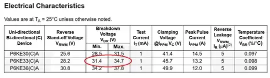

  3. With the resistors you chose for the input this would require a minimum of 3210 * 0.017 or about 57V (55 + LED Vf=1.7max) to supply the current. The voltage at the junction of R3,R1 is going to be about 10.5V.
  4. The TVS will conduct at about 31.5V minimum, at that point the current through the LED would be about 59mA and the input voltage would have to be about 189V. The peak of the AC mains cycle is only 170V, so the TVS will clearly never conduct with your design. You will also never of course reach the 59mA level into the LED, you will only get about 52mA maximum.
Update: The TVS datasheet shows that the value you used (28.2V) is the largest value where the TVS WILL NOT conduct. The value where the TVS begins to conduct (1mA is the threshold ) is between 31.4 and 34.7V. I used 31.5V for convenience, you could go back and consider best case at 31.4V. However if you consider worst case devices at 34.7V @ 1mA, then you have an even greater discrepancy in input voltage required to cause the device to conduct. Short story. The TVS in the circuit as designed is non-functional, it will never conduct.

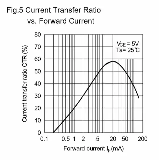

As Dave suggested you can increase the value of R2 to reduce the output sink current and therefore lower the input current required, but at lower input current the CTR drops as well. From the LTV-814 datasheet you can see that as you reduce the input current the CTR plummets.
You can see from the above, the 17mA required by your design is about ideal to maximize the CTR, though you should design for minimum CTR of 20% for the spread of devices.
If you use Dave's suggestion and use a 10K Ohm for R2 (a 500uA load), while this reduces the input current requirement you can see the CTR drops and if you look at Fig3 in the datasheet the VCE(sat) rises which means you can't pull the gate input low.
If you set the input current to be say 5mA the CTR has dropped by 25%. If you dropped the input current to 1mA, the CTR has dropped by almost 70%.

  • Also, how do you arrive at 31.5V conduction voltage for the TVS? I don't see that figure in the specsheet. – Reinderien Sep 21 '18 at 15:36
  • @Reinderien You are absolutely right, the difference in current for only the valid low level needs to be considered that gives you a range of 3 - 3.3mA. For a back of the cocktail napkin my numbers were quit OK of course. The main point was that 1) The TVS would never conduct and 2) the timing delay of C1 was seriously wrong. I could go through a detailed analysis with the spread of value but that's not what you can do on a forum like this. – Jack Creasey Sep 21 '18 at 15:37
  • @Reinderien I added detail about the TVS. Short story; it will not conduct with the values you have on 110-120V AC. – Jack Creasey Sep 21 '18 at 15:58
