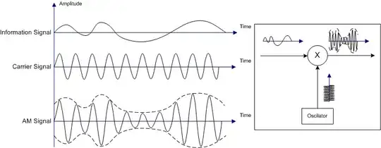

Figure 1. The Simplified analysis of standard AM from Wikipedia goes a little bit of the way to describe what you are asking.
Notice in the illustration that the waveform is not sinusoidal but is an arbitrary waveform. Notice also that the amplitude modulation just follows the signal waveform. There's not much more to it. The microphone will convert the voice into an analog electrical signal and the modulator will modulate the carrier analogously too.

    Aaaah. I got it now. I feel kinda dumb...although, certainly, no tutorial I have seen addresses the second part, showing how it works with complex waves, but I totally missed the part about the instantaneous amplitude of versus the rate of change of the amplitude being the actual frequency change. Darn it. And all these years I didn't get it. – aAaa aAaa Sep 20 '18 at 21:57
  • Have a look at the update. I found what you were looking for on Wikipedia. – Transistor Sep 20 '18 at 22:04

As shown in fig 1 of Transistor's answer, not only does the sound wave varies in amplitude, it also varies in frequency. The amplitude of the sound, modulates the amplitude of the carrier, while its frequency modulates the frequency of the carrier. So the carrier also has both information components of the sound wave. After the carrier is demodulated, both information components of the original sound wave are recovered.
Hopefully this clarifies your misunderstanding of the capabilities of the carrier, and makes it clear that it has two (not one) degrees of variability.

  • Have another look at my Figure 1. You can see that the AM frequency is constant. There is only one degree of variability - the amplitude. You are missing something in your understanding of modulation. – Transistor Sep 28 '18 at 05:40
  • You're making the same mistake as the poster - amplitude is not really separable from frequency, you only have the strengths (and phases) of frequency components, or to put it another way, a frequency is present only if it has a non-zero magnitude. To really understand the original mistake, consider how timbre is conveyed, ie how we hear a trumpet as distinct from a clarinet. Is that a third degree of freedom? No. It's just a different mix of frequency component strengths (even overtones are missing on a clarinet). The same goes for multiple instruments or multiple people talking at once. – Chris Stratton Sep 28 '18 at 06:19
  • But then Transistor is also wrong - the frequency of an AM signal is neither constant nor singular, if it were there would be no information content. The information content is all in sidebands displaced in frequency from the central or carrier frequency component. All the carrier does is serve as a reference permitting simpler detectors, vs needing to manually or algorithmically tune the local oscillator feeding the product detector that would be needed if the waste power in the constant frequency carrier component were removed (as long routine outside of legacy settings) – Chris Stratton Sep 28 '18 at 06:25
  • @Transistor: The frequency I am referring to is the sound. You can clearly see that the left side of the wave has a higher frequency than the right half. Sound does not have a constant frequency (or amplitude). – Guill Sep 28 '18 at 07:00
  • @Guill: But that's not quite what you said. "*The amplitude of the sound, modulates the amplitude of the carrier, while **its frequency modulates the frequency of the carrier.**"* – Transistor Sep 28 '18 at 11:11
