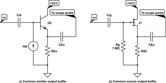

1) I found some practical advice, here and here, saying this:
[I]n the real world, for frequencies above 2MHz, a second emitter follower buffer stage is needed to prevent loading of the output stage, and reduced frequency response. The capacitance from even a 1MHz scope probe will roll the frequency of this amplifier off at 2 MHz. To measure frequency response on a scope, measure on the output of the cascode through a buffer.
Do they mean a third BJT?

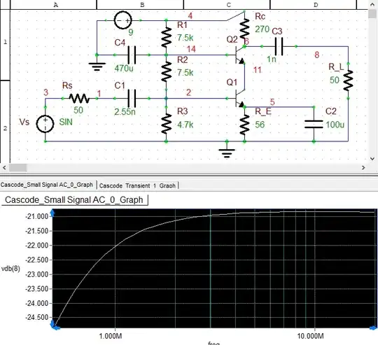

2) Another student's circuit below reaches the desired gain (23+/-0.5dB), but when implemented, the gain was half! We are soldering our circuits to perf board. The leads are kept short. Our professor suggested grounding surrounding pins. Any other practical suggestions or design tips? Ckt0

1) I found some practical advice, [here][3] and [here][4], saying this:
Yes: precisely, the advice is to use a very high impedance buffer stage at the output of the cascade amplifier, in order to not load the \$Q_2\$ BJT with the scope input capacitor, which adds at least at least other 20pF to \$C_L\$. As a matter of fact, the cascode stage sees a load impedance $$ Z_L(s)=(R_C\parallel R_L )\parallel s(C_{cb}+C_L)^{-1}\simeq (R_C\parallel R_L) \parallel sC_L^{-1}\tag{1}\label{1} $$ Two observation on this formula:
  • the \$C_{cb}\$ parasitic capacitance can be neglected due to the fact that, for the cascode circuit, it is not subject to the Miller effect: this is de facto the main advantage of this circuit in RF/Wideband amplification.
  • Due to its very high output impedance, the intrinsic voltage gain frequency behavior of the cascode stage is determined by \eqref{1} through the following equation: $$ A_i(s)=\frac{v_o}{v_{b_{Q_1}}}\simeq g_{m_{Q_1}}\alpha_{Q_2}Z_L(s)\tag{2}\label{2} $$ where \$g_{m_{Q_1}}\$ is the common emitter transconductance of \$Q_1\$ and \$\alpha_{Q_2}=\beta_{Q_2}/\big(\beta_{Q_2}+1\big)\$ is the common base current gain of \$Q_2\$.
Now, due to the strong dependence on the output capacitance of the value of the load impedance \eqref{1} and the intrinsic gain \eqref{2}, you should load the circuit in the lowest possible way with a probe, and this can be accomplished by using one of the following buffer stages:
These two nearly unity gain stages act as impedance transformers, coupling the high impedance node \$v_o\$ to the relatively high capacitance scope input. I prefer solution b) which uses a JFET, since it is easier to bias: the \$I_{bb}\$ base bias current generator is not easy to design, while the JFET needs only a high value bias resistor connected to the common DC ground.
The problem is that \$C_2\$ is no more a capacitor at the working frequencies of the circuit. The chosen value of \$100\mu\mathrm{F}\$ for the emitter decoupling capacitor \$C_2\$ implies that it should be an electrolytic capacitor, and this is deleterious since, even if an expensive model would be available, it would work as capacitor perhaps only up to the lower end of the bandwidth (500kHz): at higher frequency, the device will behave as an inductor, introducing an emitter feedback which will reduce its gain quickly. Precisely, at those frequencies such that the stray inductance of \$C_2\$ has risen its impedance well above \$R_2\$, i.e. $$ Z_{C_2}\gg R_E $$ the emitter of \$Q_2\$ sees again \$R_E\$ as it is for the DC biasing. The circuit behaves like a "split load" stage whose gain is $$ A_i(s)\simeq\frac{R_C\parallel R_L}{R_2}< 0.754 $$ For an analogous (if not the same) reason, also \$C_4\$ has a deleterious effect, introducing an unwanted feedback path from the base of \$Q_2\$ to the base of \$Q_1\$. To solve this problem, use even lower values of capacity for both \$C_2\$ and \$C_4\$, but use RF ceramic capacitors.
