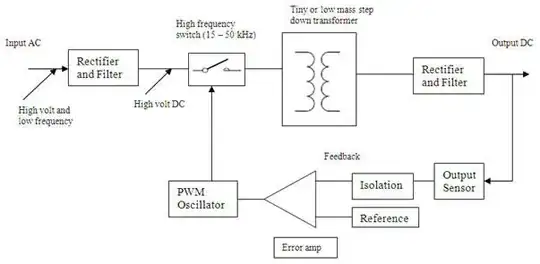

No. The power-supply does not require correct 'polarity'1 as it is insulated from ground and the datasheet (for which you didn't supply a link!) should indicate that the output is isolated from the mains.
Figure 1. A typical SMPS block diagram. Note the transformer provides isolation between the high-voltage and low-voltage sides of the circuit. Note also the isolation - usually optical - in the feedback circuit. The source of this image is lost, I'm afraid.
The one advantage of getting the polarity right is that the internal fuse in your supply will be on the 'L' line and if that blows it disconnects the rest of the circuitry from the live wire.
