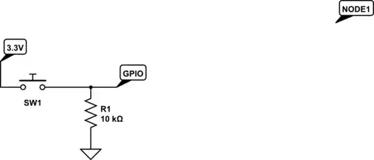

I've tried to replicate that with a NodeMCU. I have follow the same example as a push button,
3V3 -> BUTON Pin 1 |-| Button Pin 2 -> 10k Ohms -> GND
                                    -> D7 (Digital 7 GPIO)
This works fine with the switch button, but when I replace the switch button with the wires on the door, nothing happen.
I checked the Ohms on both cases, the switch on rest have 10M Ohms, and when pressed have 0.4 Ohms.
The door when is closed have continuity with 16 Ohms, when is open it doesn't have anything (no continuity, no ohms, open circuit).
What I am missing here ? Another question, if a person touch the door (has metal on it) it can catch a spark or anything ? It's safe ?
The final goal is mimic the behaviour of the multimeter.

  • What's the voltage between D7 and ground when the door is open and closed? Is there any other connection to the metal door? What's the power source? – user253751 Sep 18 '18 at 23:39
  • What do you mean by "when is open don't anything"? Is the resistance infinite or zero? Did connect both wires from the door to the NodeMCU? What voltages do you measure at pin 7 with the pushbutton? With the door? – Elliot Alderson Sep 18 '18 at 23:39
  • @immibis 0.678v in both cases. I am powering the NodeMCU (3.3V) with a power bank for now. – David Magalhães Sep 18 '18 at 23:52
  • @ElliotAlderson I've fixed the test. When is closed, there is continuity with 16 Ohms. When it's open don't exists anything. With the push button I have 0.674v when not pressed, and 3.24v when pressed. So the door is create to much resistance for the voltage to flow ? – David Magalhães Sep 18 '18 at 23:52
  • I have to ask again: when you say "don't exist anything" what are you trying to say about the **resistance**? – Elliot Alderson Sep 18 '18 at 23:58
  • @ElliotAlderson It's an open circuit. Aka no connection. – Passerby Sep 18 '18 at 23:59
  • @Passerby Yes, I assumed as much, but I'm trying to encourage the OP to improve the question. – Elliot Alderson Sep 19 '18 at 00:01
  • Sorry, yes, open circuit no connection. When I do the same in the push button it have like 10M Ohms. I've updated the text. – David Magalhães Sep 19 '18 at 00:01
  • Updated the response, checked the alligators, and after rechecking everything it start working. Now instead of 16 Ohms it was giving 6 Ohms. I'am using some thing flat cables to do this, I will need to proper solder it to avoid issues in the future. Thanks for all the feedback. – David Magalhães Sep 19 '18 at 01:20

Based on what you explained, it should work. Two wires touching is the same as a push button. 16 Ohms may not be a good connection for carrying a load, but a GPIO like this is not affected by that. The voltage divider created by this would put 3.29V at the GPIO, enough to trigger the pin as high/on/1.
So the only thing we can assume is that either there is a physical issue, or the issue is in your code.
You say With the push button I have 0.674v when not pressed, and 3.24v when pressed. I suspect you have the internal pull-up enabled. Try disabling it. You have an external pull-down, so you they can conflict.
Update: Based on OP's comment, it was (likely) a bad physical connection.

  • It isn't simple 2 wires touching. The two wires touch the metal on the door, and that makes the continuity. I will check on the internal pull up. – David Magalhães Sep 19 '18 at 00:29
    @DavidMagalhães I strongly recommend you to replace your "two wires touching metal" with microswitch like [this one](https://www.robotshop.com/ca/en/12a-roller-lever-micro-switch.html) – Maple Sep 19 '18 at 00:51
Since you get the same voltage (0.674V) with the door open and with the door closed, but with the button pressed you get about 3.3V, my bet is that the door isn't wired correctly. Double check all the connections. Make sure you test the wiring from the circuit board to the door and back again (it should measure not many ohms).
