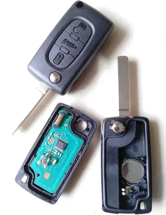

Car remotes use one-way radio signalling.
Figure 2. A Peugot 307 remote. Note there is no LED visible but there is what appears to be an inductor (top of PCB) and an antenna (to outer loop). Random image source.
How do they differ?
  • Infrared requires line of sight to the receiver or enough reflective surface to bounce the infrared light. Point the remote into your hand and the television will not respond.
  • Your car's remote control will work inside your pocket. This is the biggest clue that it is not using light as a transmission medium.
Your programmable remote control is for infrared remote only. It will not be able to receive radio signals from your car key.
