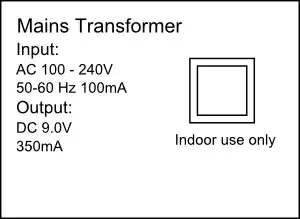

The statement by "Barrie" is nonsense, many devices don't have a ground connection and thus only have a 2-pin mains plug. Such devices are "double insulated" and have the 2-squares logo and possibly some text like:
The damage of that power strip was very likely caused by a short circuit and/or overload. There is no ground/earth connection required for that to happen. Likewise it is unlikely that a ground/earth connection would have prevented that damage from happening.
