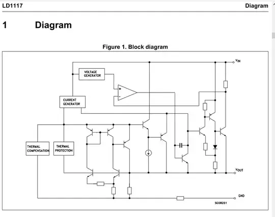

When the Vout is below ground it cannot bias the regulator to start up as the NPN's to ground are reverse biased.

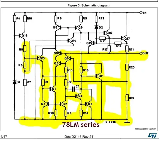

The LM85 bias network is improved and appears to prevent this issue. enter image description here
What can you do?
Consider the minimum load current 5mA and the idle current 10 mA max and use a pull-up on Vout to Vin+ that forces Gnd to be < Vout+ during V- startup. ( remember Gnd can be floating and just a 0V ref. at some point.)
How?
  • A Zener from Vin to Vout greater than the expected drop which overloads V- until V+ starts? maybe brute force method...
  • a CC regulator SMD 20mA chip from Vin to Vout? Not a good idea if the load is less than 20mA then it pulls the Vout higher since it is an emitter follower output.
  • Power management cct to ensure both are OK before enabled to IC. ( too much trouble)
  • A resistor divider that draws > 10mA from Vin to Vout and GND so the external voltage V- its pull-up ( more current ) from the V+ being off? YES
  • a simple idea may work but depends on dynamic current flow as V- starts up
  • compare with a LM317 ? maybe
Idle current spec : Vin ≤ 8V 5(typ) 10 mA (max)
Remember LDO's only source current and not sink.
But if the output is reverse biased relative to GND they cant source either because the Gnd is a controlled current sink.
Best bet
  • Power Schottky diode from Gnd to Vout with a R divider on Vout from Vin to gnd to bias the output for 10mA just below the regulated output worst case, never above.
  • My application is very noise sensitive, I can't use any switching ICs. Why doesn't the L78M05 have this issue? It seems to start up fine despite having a similar block diagram? – user2022444 Sep 07 '18 at 18:22
  • @user2022444 That TO-220 regulator was most likely in the 78X family, which are not an LDO, by any stretch of the imagination. To a degree LDOs are a compromise, in that they trade stability for performance. As an example, it's fairly hard to get a 78X to oscillate, whereas with a LDO, sometimes with even no to minor violations of their output requirements, they will sing like a bird. In this case, without looking at the datasheet for the old regulator(which you never told us), I would guess it has a built in bias circuit, therefore it does not require an external one. – GB - AE7OO Oct 20 '19 at 19:54
