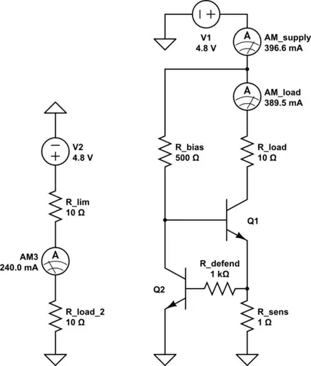

I have made a simulation of this circuit using CircuitLab. I show the results below. The circuit on the left uses a simple series resistor to do the current limiting while the circuit on the right is based on the Wikipedia circuit. I have tweaked the values of R_bias and R_load to common resistor values that prevent more than 480 mA being drawn from the source when the load is 0 Ohms. I also set hFE of the transistors to 65 to match some multimeter measurements I made of some power transistors that I have to hand. The values adjacent to the ammeters are the simulated values.
If I now make a 10-Ohm load, it becomes clear why a current limiting circuit is superior to a series resistor. The current limiting circuit drops its effective resistance, allowing more current through than when using a series resistor . .
However, the current limiting circuit is still providing some series resistance in this case. An ideal current limiter would have no resistance at all until the load attempts to draw more current than the limit. Is there a way to tune R_bias and R_load to better achieve this, and/or are there circuit tweaks that can help better achieve this?

The circuit shown will work, but the transistor and Rsense create a voltage drop that must be taken into account.
What you are seeing is the effect of this:
At 480mA the voltage drop across the 10Ω resistor would be 4.8V, which leaves no "room" for the transistor saturation voltage or the Rsense voltage drops.
So the current will be (Vsupply - Qsat - Vrsense) / Rload. To fix this, raise the supply by a couple of volts and try the 0Ω and 10Ω tests again. Also, lower Rdefend considerably (<10Ω)
You should hopefully see (almost) no difference.
For better results, the more gain you have the better. Another thing to note is (as Dave mentions in his answer) that Rbias needs to have a higher limiting point than the Rsense setting, otherwise it will dominate. If the transistor has a gain of 65, and you want Rsense set for 500mA, then Rbias must be set to allow more than 500mA. At 500Ω, it will set the absolute limit at 65 * ((5V - 1.4V) / 500Ω) = 468mA, so even if Rsense were set for 500mA you won't get it. To avoid this set Rbias for e.g. 250Ω, or as mentioned below use a MOSFET for Q1 and then the value isn't as important (10kΩ will do)

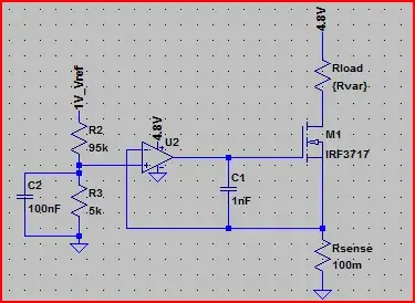

Another option is to use a common opamp constant current circuit:
Opamp Constant Current

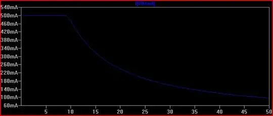

Simulation with a supply of 4.8V, current limited to 500mA, Rload swept from 1mΩ to 50Ω and current through it plotted relative to this (note current stays flat at 500mA whilst limited):
Constant Current Sim
This meets your requirements of a solid 500mA limiting at 4.8V supply, and is easily adjustable by varying the opamp non-inverting via input voltage R2/R3 divider. The formula is V(opamp+) / Rsense = I(Rload) For example, the 1V reference is divided by 20 to provide 50mV at the opamp+ input, so 50mV / 100mΩ = 500mA.
A MOSFET is used to avoid base current errors complicating matters (a MOSFET with low Vth can also be used in the original transistor circuit to improve things)

  • Interesting. I bumped the supply up to 6.8V, tweaked R_bias to 780 Ohms to give a limit of ~0.5A at short, then tried the 10 Ohm load and saw a current dip of only ~20 mA rather than the >80 mA shown above – learnvst Sep 03 '12 at 20:54
  • Try it at e.g. 10V/500mA, you should see less than 1mA difference. – Oli Glaser Sep 03 '12 at 20:59
  • Still dropping about 20 mA in the simulator, but it is good to know. Sadly, I have no control over the voltage in the application I plan. But this is all good stuff! Thanks – learnvst Sep 03 '12 at 21:03
  • Interesting - what transistor are you using for the simulation? (I just did a check in my simulator and I get ~200uA change) – Oli Glaser Sep 03 '12 at 21:05
  • 2N3904 (The default in CircuitLab) with gain changed to 65 so it behaves more like some power trans that I have (TIP31C). Is this a wrong thing to do? – learnvst Sep 03 '12 at 21:17
  • It shouldn't affect things that much, but I have just simulated your circuit in LTSpice using a generic .model statement and setting the current gain to 65 to match things exactly, and I get only ~200uA change between 1 milliohm and 10 Ohms for the 10V / 500mA scenario (Rsense 1.65 ohm, Rbias 500 ohm), which is close to what I'd expect in reality. I also tried with LTSpice's 2N3904 and I get similar, so somethings not quite right I think. Try removing the gain alteration to see what happens, it may be causing issues. – Oli Glaser Sep 03 '12 at 21:25
    I just realised your Rdefend is 1 kOhm, not 1 Ohm as I originally thought. This will make a difference, try lowering it to 1 Ohm. – Oli Glaser Sep 03 '12 at 21:38
  • Ok, with the changes you suggested I get ~700uA drop in supply current. Interesting stuff :) Still odd that the simulators do not agree, but way more than close enough for my liking – learnvst Sep 03 '12 at 21:52

  • Why C1 is there? It is about the parasitic gate-source capacitance. And will slow down the reaction to fast changes of the load (e.g. short circuit accidents). – Valentin Stoykov Jan 25 '20 at 19:31
I think there's a fundamental misunderstanding here. It isn't Rbias that's supposed to set the limiting current value, it's the combination of Rsense and the Vbe drop of Q2.
Your first circuit has two different current-limiting effects: One is the current through Rbias multiplied by the gain (current transfer ratio) of Q1, and the other is Q2's Vbe divided by Rsense. The first gives the value of 470 mA that you see, but this is poorly controlled. What's happening in this mode is that the circuit is behaving like a resistor that has the value of Rbias/Hfe, or about 7.8Ω in this case. The current is still going to vary with the supply voltage.
The second mechanism would give you a value of about 600 mA (i.e., 0.6V / 1Ω), with a much more sharply-defined "knee" — the effective source resistance in this case is Rsense multiplied by the combined gains of Q2 and Q1, which is much closer to an ideal current source. However, you're not getting to the level of current where this mechanism would kick in.

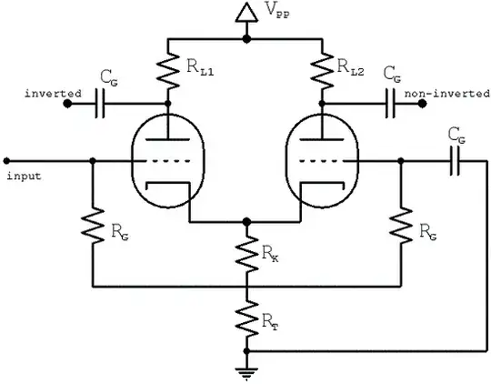

Circuit below is from here which provides a build up up from one transistor on through -
If that makes no sense then a look at
Wikipedia - differential amplifier
and this will provide many leads
