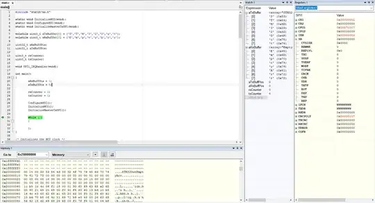

To illustrate, this is the debugger output before initiating the transfer: enter image description here
Ideally, the contents of aRxBuffer should be overwritten after the transfer has commenced. In reality, the MCU transmits all of its data properly, albeit it receives all-zero data instead of what was actually sent: enter image description here
