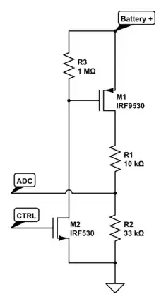

  • (EDIT: Resistor values updated and P-MOSFET switch added based on @stevenvh and @Jonny's suggestions).
  • I connected a voltage divider from the battery V_plus, with the larger "portion" going to an analog-read-pin (i.e., ADC) on the Arduino/Atmega chip.
  • The divider is 33 KOhm-to-10 KOhm, thus allowing measurement up to 4.1 Volts maximum of the Li-ion battery from my 3.3V level microcontroller.
  • Also, using one of the I/O pins connected to an n-channel MOSFET, I can switch the current through the divider only when I need the measurement.
  • Here is a rough schematic (updated for a 2nd time based on suggestions of @stevenvh and @Nick):
My question:
  • How is my current setup?
  • My only constraints are: (1) I would like to make a rough measurement of the battery capacity based on the voltage reading, as described above. (2) I would like to prevent the voltage divider from interfering with my charging IC's reading of battery presence (in my original setup, the divider sometimes caused the IC to misread presence even when the battery was absent).

    You've got the wrong FET on the wrong side. If you switch this one off the full voltage will be on the input pin, since R1 won't draw current. You need a P-MOSFET on the high side, so that switching it off pulls the I/O pin to ground. – stevenvh Sep 03 '12 at 17:29
  • The high-side switching makes sense. Also, I used an N-MOSFET because I happened to have one; can't I make it work with one? – boardbite Sep 03 '12 at 17:43
  • Finalized schematic with the P-MOSFET; thanks a bunch! I'd still appreciate a pointer regarding the N-MOSFET alternative, just for future knowledge. – boardbite Sep 03 '12 at 17:54

First why you can't use the N-FET on the high side: it needs a gate voltage a few volts higher than the source, and the 4.2 V is all you have, nothing higher, so that won't work.
I have a higher value for the pull-up, though a value of 100 kΩ also will do. 10 kΩ will cause an unnecessary extra current of 400 µA when you're measuring. Not the end of the world, but it's 1 resistor in both cases, so why not use a higher value.
For the MOSFETs, there are a variety of parts to choose from given the requirements are not so strict; you can consider inexpensive ones such as, e.g., Si2303 for the P-channel and BSS138 for the N-channel.

    @Inga - You don't need current, so the on-resistance is not that important. Just look at the gate's threshold voltage: it should be on at 3.3 V, but even then it doesn't have to sink any current, and then there's plenty of choice. The [BSS138](http://www.fairchildsemi.com/ds/BS/BSS138.pdf) is one of the cheapest I could find, and will do nicely. – stevenvh Sep 05 '12 at 13:45

Your microcontroller (uC) is powered with +3.3V. Drain of the proposed P-MOSFET can be as high as +4.1V. As it's currently drawn, a +3.3V logic signal will not be able to turn off the P-MOSFET fully. Q6 in the schematic below forms an open drain output, which is tolerant to +4.1V.
C14 lowers the impedance, which your A/D will see.

Why not a single N-channel MOSFET on the low side and the two resistor divider on the upper side?
[from a comment below]
A low-side switch has problems when the battery voltage (Vbat) is greater than the microcontroller's supply voltage (Vcc). When the low side switch is off, the ground end of the voltage divider floats, the divider no longer divides, the full battery voltage appears on the microcontroller's ADC pin. This can damage the uC. It will also create a leakage path through which the battery would discharge.
A high-side switch is called for when Vbat > Vcc.

  • Why not a single N Mosfet on the low side and the two resistor divider on the upper side? Can't see why is necessary to use a N Mosfet to drive the P Mosfet – Luis Carlos Jun 17 '18 at 00:19
    @Luis I've edited the answer and added the response to your comment. – Nick Alexeev Jun 17 '18 at 01:13
