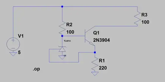

Here is a quick LTspice simulation with a 100 ohm resistor as a load:
Ic(Q1):  0.0113147   device_current
Reduce the 100 ohm resistor (R3) to 0 ohms and we have:
Ic(Q1):  0.0113152   device_current
So it's a pretty good current sink. Output resistance (ideally it would be infinite) is about 2M\$\Omega\$.
Similarly, if I increase the supply voltage to 10V with R3 constant at 100 ohms, I get:
Ic(Q1):  0.0113529
So about +0.06% per volt line regulation. That could be improved by increasing R2. With R2 = 1K the line regulation is improved to +0.01%/volt and load regulation is slightly better too.
