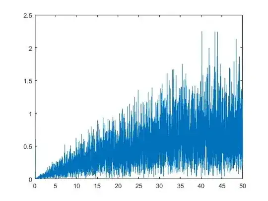

EDIT: In response to the downvote, I'll hammer this home with a concrete example. Let me take a sine wave, and add some random normal noise to it (one tenth the magnitude of the sine wave)
The fft of this signal is:
Now, let me take the derivative of the signal: enter image description here
and the fft of the derivative
Undersampling will, of course, alias either the signal or the derivative. The effects of the undersampling will be modest for the signal, and the result of undersampling the derivative will be absolutely useless.
