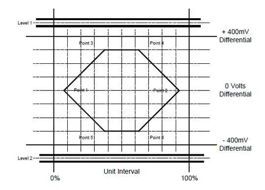

To test a USB high speed transmitter, you have to test the TP3 mask:
The horizontal position of point 3 is at 37.5% UI, and point 6 is at 62.5% UI, so you are trying to measure a rise-time of about 75% of 2.08 ns, or about 1.5 ns.
A 500 MHz scope will measure a minimum risetime of about \$0.75/500\ {\rm MHz}\$, or 1.5 ns.
You can estimate the risetime you measure will be about
$$\tau_{meas}\approx\sqrt{\tau_{scope}^2+\tau_{sig}^2},$$
so a 500 MHz scope is not going to cut it. I'd look for at least 1 GHz, and 2 GHz will help if your product doesn't have much margin.

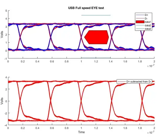

I ended up using a single ended measurement and using matlab to poll the textronix scope and using the instrument control toolbox:
myScope = oscilloscope
drivers(myScope)
availableResources = getResources(myScope)
availableResources{5}
myScope.Resource = 'TCPIP::xxx.xxx.xxx.xxx::INSTR'
connect(myScope)
get(myScope)
waveformArray = getWaveform(myScope, 'acquisition', true);
figure;plot(waveformArray)
enableChannel(myScope,'CH3');
enableChannel(myScope,'CH4');
Time = linspace(0,myScope.AcquisitionTime,myScope.WaveformLength);
aqs = 1000;
for i = 1:aqs
[w3, w4] = readWaveform(myScope, 'acquisition', true);
pause(0.05);
w3mat{i} = w3;
w4mat{i} = w4;
end
figure;subplot(2,1,1),hold on,legend('D+','D-'),subplot(2,1,2),hold on
for i = 1:aqs
w3 = w3mat{i};
w4 = w4mat{i};
subplot(2,1,1)
plot(Time,w3,'b'),plot(Time,w4,'r')
subplot(2,1,2)
plot(Time,w3-w4,'r')
end
subplot(2,1,1),legend('D+','D-'),ylabel('Volts');
subplot(2,1,2),legend('D+ subtracted from D-'),xlabel('Time'),ylabel('Volts');
subplot(2,1,1)
x = [8.2  21.15 69.93 75.13 69.93 21.15 8.2 ]*1e-9/2;%These come from the USB IF website specs
y = [1.65 2.5   2.5   1.65  0.8   0.8   1.65];
fill(x+1e-7,y,'r')
title('USB Full speed EYE test')
line([1e-7 1.4e-7  ],[-0.9  -0.9])
line([1e-7 1.4e-7  ],[4.4  4.4])
