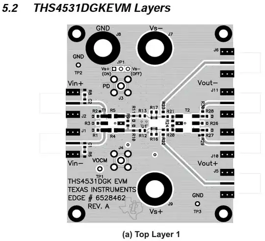

I was looking at an example board schematic provided by TI and I noticed something rather curious: vias were placed directly on SMD pads.
Is this a normal/acceptable practice to follow, or is it recommended/better to put a short trace and then have a via?
Example:

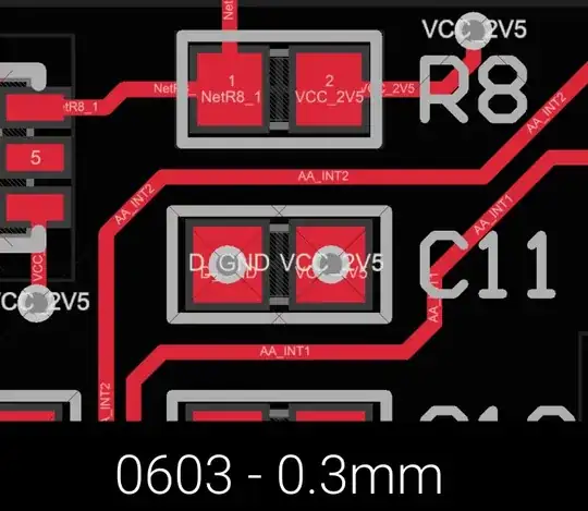

I'm talking with experiences not imaginary recommandation with no actual evidence to back it up. You already asked for the smd pads not BGAs, nevertheless I saw many answers that only cover up for BGAs/ICs fanouts not the passive components.
To put it short, yes you can but you need a little care along the way.
Myth: via-in-pad is a bad practice
Via in pad is a bad thing if your via's hole occupy more than 30% of the pads area AND if your pad is too small too! If your pad be too small and you use mechanical drill this might blow out the pad. In this case your manufacturer may recommand to you that use laser drilling instead of mechanical drill and it surely cost you more. Moreover in the assembling proccess to avoid sucking out solder paste you need to resin plug these vias too which again cost you more.
Via In Pad for Passive Components
But all these recommendation are only for the BGA parts, If your pad be big enough and your hole size be small relative to the pad size (like the TI board you mentioned) you don't need any laser drilling nor plugging the vias because it's effect will be too small to be noticable.
My Experience
I've had a succesful experience with placing 0603 component (imperial) with 0.3mm via in it and 0402 component (imperial) with 0.2mm vias in it on my board. In both of these cases I had used mechanical drilling with no resin plugged holes. I doesn't saw any defect on a batch of 1000 board with more than 40 component like the following figure enter image description here

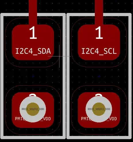

Placing vias over SMD pads is pretty common and an acceptable practice provided you take good care while designing. Here are some practices I follow when I use Via in Pad:
  1. I don't tend to use through hole via in pad for 0201 passives. The pads for an 0201 are pretty small for a through hole mechanical drill and may damage the pad in the process.
  2. When it comes to 0402 passives, I use a 0.15mm/0.2mm through hole mechanical via in pad.
0402 SMD via in pad
  1. When it comes to 0603 and 0805 passives, I use a 0.2mm/0.25mm through hole mechanical via in pad.
  2. I even used a 0.15mm hole/0.4mm pad via in pad on a BGA package (DDR3L RAM). Of course my BGA package's pad size was 0.41mm. The via fit in without any issue in manufacturability. Since the hole was pretty small, the common problem of solder flowing into the hole is negligible.
BGA package, via in pad
PS: Many people say it is a bad practice but I used this approach in many designs which went into production (5K pcs volume) and they've had no issue since then.
Good luck with your design!
