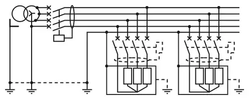

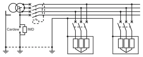

In electronics, we call anything that is defined as the 0V reference as "ground" to be shared by a circuit, regardless of whether it is floating or "earth-bonded". This "earth" goes to the network and your home, to your outlets and the equipment which uses it.
However, this "Protective Conductor" term is used for the power grid network in many places and with different specifications how it is implemented.
The earth-connection generally serves 2 purposes, a drain for EMI and a safety wire for appliances, residential and grid power in case of faults or lightning.
Depending on the network, there are different ways to connecting "ground = 0V" of a system to an earth terminal.
TT system enter image description here
TN-C enter image description here
TN-S enter image description here
IT System enter image description here
