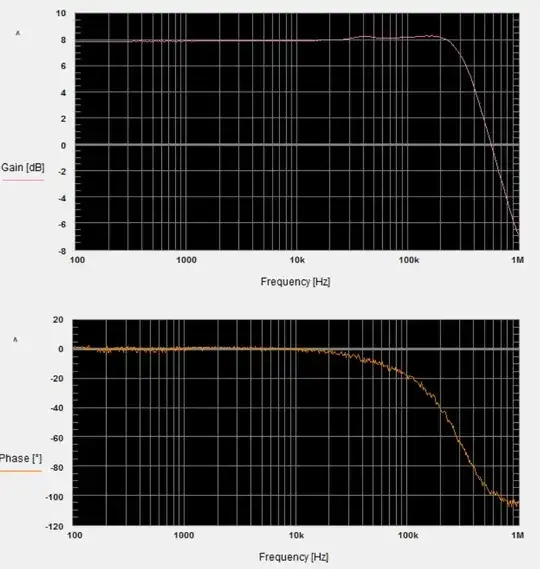

The gain/phase bode plots I made on the PCB:
G/P plot
Bandwidth of approximately 350kHz! Very pleased.

  • Good news! i borrowed some BNC cables and soldered that to the PCB to make some better gain/phase plots, and it is way better now! I updated the first post with the results, and i will mark your post as the solution. Thanks for your help! – Linkyyy Aug 28 '18 at 14:02
