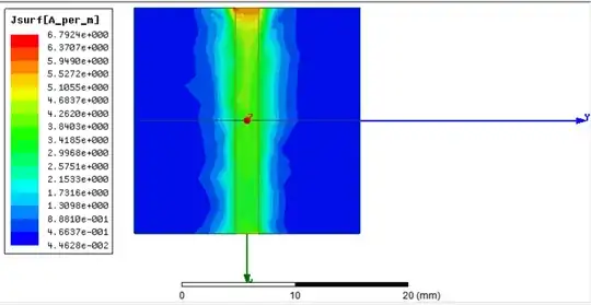

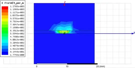

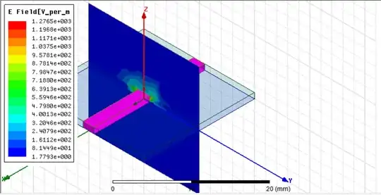

To keep microstrip line impedance unchanged by a ground plane slot, the slot must be located at least two microstrip widths away (if the microstrip is projected vertically to the ground plane).
Below are several pictures from a 3D field solver showing distribution of electric field inside the micrsotrip and current density in the ground plane. The conclusion there is almost no field or current two width away from the micrsotrip. So ground plane breaks are allowed here.
Figure 1: Electric field cross section perpendicular to the stripline. 2D view. enter image description here Figure 2: Electric field cross section perpendicular to the stripline. 3D view. enter image description here Figure 3: Current density in the ground plane. 2D view enter image description here Figure 4: Current density in the ground plane. 3D view enter image description here
