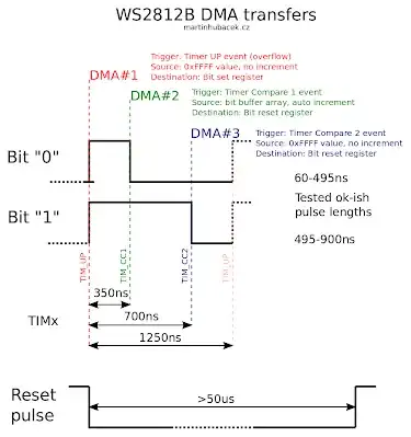

Below is an image which explain how the whole Timers and DMA's are configured to drive the WS2812B WS2812B timer and DMA config
I tried debugging to see if the DMA's were being triggered by putting a breakpoint in the halftransfer-callback and found that it wasn't triggered. Then i tried putting a Breakpoint in Timer-elapsed-callback and found that it wasn't triggered either.
I tried serching online and found a few similar examples and i feel that the DMA's and the timers are not configured properly.
Here is the portion of the code which as per me could be wrong:
