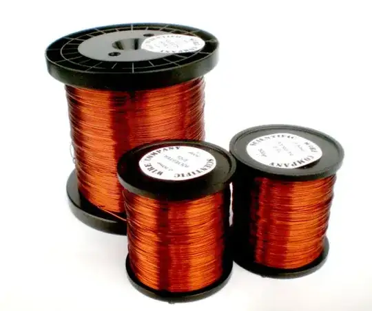

I'm trying to work with Enammelled copper wire such as below, used for winding transformers due to its insulation. How on earth do you work with this type of wire?
When cutting the wire, the internal exposed copper surface is so small it makes a very weak connection. Am I supposed to blast the Enamel with heat and melt it away? Are there any common practices when working with this type of wire?
