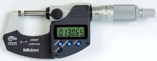

I've seen this type of LCD many times in weigh scales, calculators, gauges, micrometers, etc. I know it's a fairly traditional display but I really like its compactness, simplicity, and maybe it even costs less, versus TFTs or smartphone-type touch displays.
Digits-only LCD
[What is it called? Answered by @kevlar1818 and @stevenvh: "Seven-segment display"]

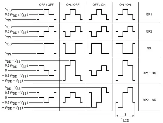

Driving LCDs can be awkward since they don't use just two levels, so you can't drive them with common digital logic.
The best thing you can do is select a microcontroller with integrated LCD controller, which you can connect the display directly to, like the TI MSP430x4xx. Like most controllers this one also knows just segments; it isn't aware of digits or anything. (Great, first we had a dumb display, now we have a dumb driver as well!) There's reason for this. These LCD drivers are often used to drive custom LCDs which may be a mix of a numeric part, bar graphs and custom symbols. Such a symbol is also a single segment, so it makes no sense to talk about digits.

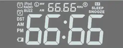

This display has symbols like "battery" and "alarm clock", but also all text fields, like "AM", "PM" and "SNOOZE" are symbols consisting of a single segment (i.e. controlled by a single bit).

  • @Inga - No, you can't use the MAX7219, that's a LED driver. For one thing they multiplex much too fast for LCDs. The multiple levels shouldn't be a problem; that's what you've got a driver for. That takes care of everything. What do you think of the intelligent driver which keeps count of the number to display? You could use commands like "load value", "increment count", "reset count", etc. – stevenvh Aug 29 '12 at 13:47

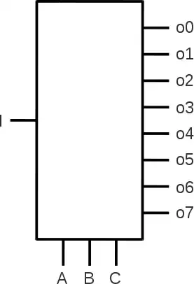

(de)Multiplexing is a good method for lighting up a large 7-Segment panel, although not necessary. If your I/O ports are limited then it's the way to go. The basic's of demuxing work like this (assuming you know binary here). Look at this picture:
With a 3 bit binary number like 000 we can represent up to the number 7 (I.E. to select port 5 we'd have ABC be 101). What would happen in the demux in your situation is one input is something like a high signal, and AB&C are I/O ports. The 0 to 7 are connect to each segment of the LCD and by writing to ABC from your controller you can light up a segment. You may be saying wait but if I want to light up a number I need many segments lit, not just the 5th segment. Well after that you can look into two roads to get the LCD to display a number. The first is add more demux's for additional needed segments. The second is a software approach which involves very very quickly flashing each of the segment required to create the illusion that the panel is completely lit. The AVR chip in your mega is operating in the Megahertz range if you write a loop to display ABGED (from the wiki pic) you will end up seeing something that looks like a number 2. Hope this gets you started.
