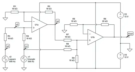

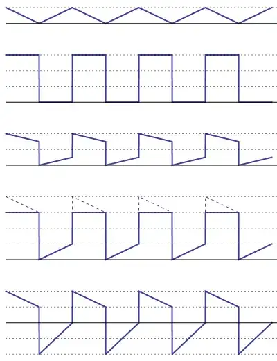

The positive slope of the triangle wave needs twice the gain of the negative slope, this can't be done in an opamp and resistors circuit without some trick:
Signal s1 = triangle wave, 0 V to +4 V
Signal s2 = square wave, 0 V to +12 V
Signal s3 = s1/2 + s2/2, 0 V to +8 V
This is where the trick comes in. The triangle wave's slopes are symmetrical, and we need them different. Trick: use a rail-to-rail opamp with a \$\pm\$12 V supply. We'll use that to clip the top of the s3 waveform.
Signal s4 = 2 \$\times\$ s3 (clipped), 0 V to +12 V
Signal s5 = Vout = s4 - 8 V + s1, -8 V to +8 V
Schematic, just 2 opamps and 9 resistors:

    Brilliant! That's a nice solution. – Adam Lawrence Aug 27 '12 at 16:52
  • Indeed this is a nice an 'simpler' solution (without using integrators, half wave rectifiers, etc) Am I right if suppose you were adding/mixing signals and adjusting in amplitude for the desired amplitude output and you eventually did find out that subtle trick. I ask this since need to develop or figure out a technique (preferably a known technique) to design with op-amps for this specific case. Thank you. – Favner Aug 27 '12 at 19:00
  • @Madman - Thank you! Though I think it's more of a dirty trick than a brilliant one :-). I quickly realized it had to be something like this. I thought about it all day, and I can't see any other solution, at least not with just resistors. (Oli's a cheater! :-)) – stevenvh Aug 28 '12 at 11:57
  • @stevenvh: bounty awarded based on clever solution within the constraints. Kudos for Oli Glaser for original use of opamp as diode. – Federico Russo Sep 03 '12 at 14:04

  • The constraints are only opamps and resistors, but I don't know if there are other solutions then than my dirty trick. I'd like to see one though. – stevenvh Aug 27 '12 at 23:45

    @Aaargh! That's even a badder cheat than mine! :-) It costs you two extra opamps though. Maybe you can replace the resistors by opamps as well? ;-) – stevenvh Aug 29 '12 at 07:15

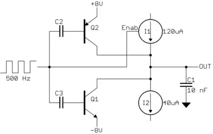

What makes this problem tricky is that you don't just have the sum of a triangle wave and a square wave. The negative steps of the square wave are -12 V, but the positive steps only +8 V.
Trying to create the final signal as a composite of several signals as Steven and Oli suggested is perfectly valid and may in fact be the best answer. However, here is a different way to think about this problem.
Consider a capacitor that can be charged and discharged with fixed currents, and can also be clamped high and low "instantly" to +8 and -8 volts. Just to pick something, let's use a 10 nF capacitor for example. To discharge it by 4 V in 1 ms would require -40 µA. To charge it 8 V in 1 ms would require +80 µA. You could have separate -40 and +80 microamp sources that are enabled at the right time. However, it's probably easier to to have a fixed -40 µA source and a switchable +120 µA source.
Everything can be driven from a 500 Hz square wave. the 120 µA current source is enabled when the square wave is positive (during 1-2 ms and 3-4 ms in your diagram). The low side clamp is enabled for a short time from the rising edge of the square wave, and the high wide clamp from the falling edge. Since the voltage is reset to one of the clamp limits once per millisecond, this method nicely avoids runaway if the steps and ramps don't add up to exactly zero per cycle.
This is not a schematic, just a diagram of the general concept. I have NPN and PNP transistors for the clamps only to show the general idea. There would be more required, like a diode and/or resistor, to reset C2 and C3 in time for the next use if bipolar transistors are actually used. Current sources can be created with opamps, and there are various ways to switch one on and off.
Again, this is a concept only with the details left as a exercise. However, I think this could be workable depending on a lot of stuff you haven't told us, like accuracy, output drive, speed of the edges, etc. I could get into more specifics if this is a direction you are interested in.

  • Do I understand you correctly that the current sources are for the slopes, and the transistors/capacitors for the steps? I know it's only a concept, but can this provide feedback so that it doesn't runaway, like if the negative steps would be only 2 V different from the positive ones? – Federico Russo Aug 29 '12 at 12:46
  • @Federico: Yes, the current sources provide the ramps and the two clamps the "instantaneous" steps. As I said, this doesn't run away since the output is clamped to a fixed voltage once every ms. Errors don't accumulate past the clamp events. – Olin Lathrop Aug 29 '12 at 12:52
