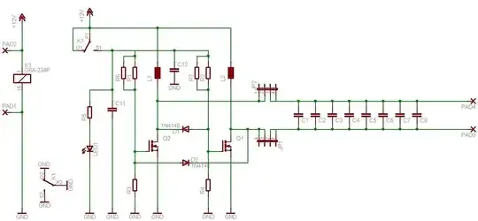

Another superb example

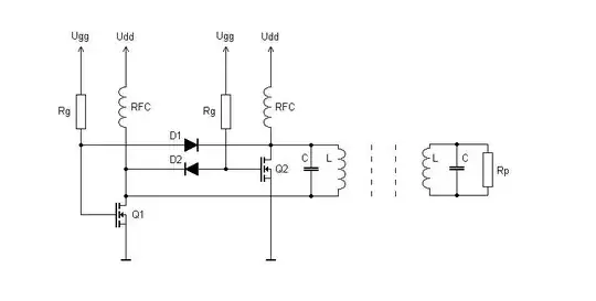

A slightly more complex but very effective and very well documented version
Excellent demo video - watch this first
Project page

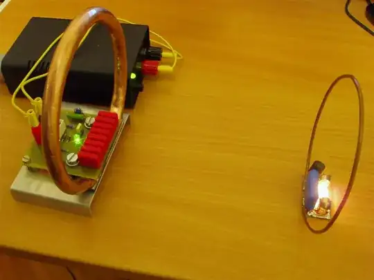

Basic circuit:
Final actual circuit:
In action. Copper tube is used for the inductor to allow high circulating currents with low resistance and so low loss when no power is being transferred.
