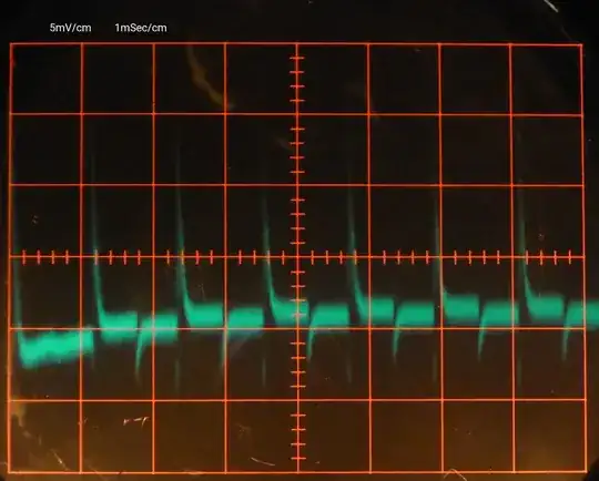

However, I can make it modulate when I apply a signal on the base of the transistor in block n°2 through a resistor. At best (adjusting signal frequency and amplitude), I manage to get a pretty good modulation (at the bottom, the TTL output of my generator):
Modulated RF signal
