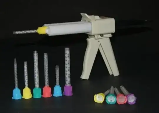

If using epoxy, there is a device called a static mixer which will mix the epoxy in the nozzle so that you don't need to mix up a larger batch and have it set before the work is complete.
BrianV
  • 550
