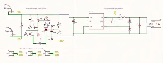

I have a deployed design in which we are experiencing a high (~4%) failure rate in the 12V to 5V step-down buck converter portion of the PCB. The buck converter's role in the circuit is to step down 12 V input (from a connected lead acid battery) to 5V, which is then fed to a USB-A receptacle for battery charging purposes.
All returned units have the same characteristic blown-up buck converter IC.
The IC is a TPS562200DDCT from Texas Instruments (reputable manufacturer, so I hear)
Here is the datasheet.
Here is a picture of a failed unit:
Here is the schematic:
Here is a look at the PCB design file for that section of the board:
In analyzing the failure of the buck converter IC, I think that you can ignore the low battery cutoff circuit. That portion of the circuit simply uses a reference voltage and low-side pass FET to cut off the battery's negative terminal from the rest of the circuitry when the battery's voltage drops below 11 V.
It seems to me that an external short circuit on a device connected to the USB receptacle would not be a culprit, since the TPS562200DDCT has overcurrent protection built into it:
7.3.4 Current Protection The output overcurrent limit (OCL) is implemented using a cycle-by-cycle valley detect control circuit. The switch current is monitored during the OFF state by measuring the low-side FET drain to source voltage. This voltage is proportional to the switch current. To improve accuracy, the voltage sensing is temperature compensated. During the on time of the high-side FET switch, the switch current increases at a linear rate determined by VIN, VOUT, the on-time and the output inductor value. During the on time of the low-side FET switch, this current decreases linearly. The average value of the switch current is the load current IOUT. If the monitored current is above the OCL level, the converter maintains low-side FET on and delays the creation of a new set pulse, even the voltage feedback loop requires one, until the current level becomes OCL level or lower. In subsequent switching cycles, the on-time is set to a fixed value and the current is monitored in the same manner. If the over current condition exists consecutive switching cycles, the internal OCL threshold is set to a lower level, reducing the available output current. When a switching cycle occurs where the switch current is not above the lower OCL threshold, the counter is reset and the OCL threshold is returned to the higher value. There are some important considerations for this type of over-current protection. The load current is higher than the over-current threshold by one half of the peak-to-peak inductor ripple current. Also, when the current is being limited, the output voltage tends to fall as the demanded load current may be higher than the current available from the converter. This may cause the output voltage to fall. When the VFB voltage falls below the UVP threshold voltage, the UVP comparator detects it. Then, the device shuts down after the UVP delay time (typically 14 μs) and re-start after the hiccup time (typically 12 ms).
So, does anyone have any idea how this could have happened?

    What else, if anything, is connected to that battery? Is it charged with the circuit connected? Abs. max for that chip is only 17V which is not much margin compared to the 13.8V of a lead-acid cell under charge. – Spehro Pefhany Jul 24 '18 at 13:25
    Being an automotive application , I see no protection to automotive surge dump and reverse voltage and +24V boost – Tony Stewart EE75 Jul 24 '18 at 13:37
    There are quite a few of the layout guidelines in the datasheet not being followed, and it also recommends a ceramic cap for the input instead of the aluminum electrolytic you have. – brhans Jul 24 '18 at 13:37
    Does it get hot under normal operating conditions? I had that twice: 1/ With a design which had the wrong induction. (Saturation current) 2/ A (different) design where 5V was fed back from the USB port. – Oldfart Jul 24 '18 at 13:38
  • @SpehroPefhany Nothing else is connected to the battery. The battery gets disconnected from this PCB when it is being charged. The maximum battery voltage should never be above 14 V. We have data verifying that max battery voltage is 14V. Do you think stray inductance on battery plugin causing a voltage spike above 17V would be enough to fry the buck converter? – macdonaldtomw Jul 24 '18 at 13:58
  • @TonyEErocketscientist this is not technically an automotive application. We just happen to be using stand-alone motorcycle batteries for energy storage. – macdonaldtomw Jul 24 '18 at 13:59
  • @brhans your notes about less than ideal layout guidelines have been taken under advisement, as have your notes on improper input capacitor selection. Thanks! – macdonaldtomw Jul 24 '18 at 14:01
    TI a reputable manufacturer? I'm not so sure. Support is poor and I've had a few bad op amps with design flaws – Voltage Spike Jul 24 '18 at 14:04
  • @Oldfart It doesn't seem to get hot under normal operating conditions. The inductor I used was one of the ones suggested by TI WebBench Designer. I have added a link to that reference design in my original post. – macdonaldtomw Jul 24 '18 at 14:06
  • What length are the wires that connect to the battery? – Andy aka Jul 24 '18 at 14:27
  • @Andyaka the wires that connect to the battery are about 6 inches long – macdonaldtomw Jul 24 '18 at 17:14

I suspect overvoltage on the chip, with a second possibility inductor saturation as @oldfart suggested in a comment.
Your supply bypass is an electrolytic capacitor, a little far from the chip and is a small electrolytic so it has a relatively high ESR (and, unfortunately, an ESR that will increase as the capacitor ages).
The input ripple current, in combination with stray inductance from wiring can lead to overvoltage on the chip input. I suggest testing it with a supply with long wires and test at the limits of the supply range. Put an oscilloscope on the power rails and see how big the spikes are. A ceramic 22 µF capacitor with an electrolytic (e.g. 1000 µF/25 V 105 °C) in parallel, if you have room, would be much better. Check that the "22 µF" ceramic is over 10 µF at the maximum operating voltage. It should be as close as practical to the chip. And, of course, it's best to follow the suggested layout practices in the datasheet as closely as practical.
Inductor saturation is a different issue- it would tend to occur at minimum supply voltage where the input current is maximum. You can test it by bypassing your undervoltage lockout and reducing the input well below the minimum normally expected. Symptoms would be excessive power dissipation in the chip.

Problem: cheap high ESR capacitor and ignoring design application notes.
Edit
Ignoring car applications if it does not apply, take note of requirement for low ESR capacitors.
For this design two TDK C3216X5R0J226M 22 μF output capacitors are used. The typical ESR is 2 mΩ each. The calculated RMS current is 0.286 A and each output capacitor is rated for 4 A.
Note that 22 μF * 2 mΩ = τ = 0.044 μs is excellent ceramic performance, where low ESR electrolytic capacitors are < 1 μs and general purpose electrolytic capacitors >> 100 μs. Since f >> 50 kHz this is critical for regulation and improved with three of the suggested parts in parallel.
It is impossible to achieve this low ESR*C = τ in an aluminum electrolytic capacitor, even with ultra-low ESR types. This is why ceramic is used in this design.
If the ESR is too high and reactive step loads are applied then there is more chance for instability, higher ripple voltage, and overshoot.
If you do not have automotive design or test specifications or a DVT test plan with stress testing, this design had not been completed properly.

Through destructive testing here in the lab, it would appear that the most likely cause of this melted pile of buck converter innards was application of reverse polarity to the buck converter.
Thanks to all for your insights, I will definitely be using them to improve the next iteration of this design.
