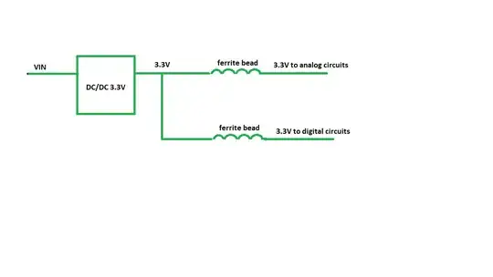

Now we are going to use the following scheme: block diagram of power supply with ferrite beads instead of LDOs
The main benefit is decreasing the BOM cost. But would it separate the digital and analog sub-parts of the PCB?

Ferrite Beads and LDOs are typically solve two different kinds of noise problems, so very rarely will you be able to "replace" an LDO with only a Ferrite Bead.

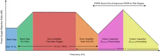

LDO's ability to filter noise is typically characterized as Power Supply Ripple Rejection (PSRR) and most LDOs are generally good attenuating Low Frequencies, but due to their bandwidth limitations don't attenuate high frequencies very well, the 8.1.3.1 Power-Supply Rejection Ratio (PSRR) Section of the TPS7A87 LDO's Datasheet illustrates this well:
Power-Supply Rejection Ratio Diagram
If you look at the PSRR for LP2980-N, found on Figure 25 of its Datasheet (see below), you will see the LDO's PSRR starts rolling-off at around 1 kHz and at higher frequencies it is actually the Output Capacitor filtering noise (notice the improvement of the PSRR plot as they increase COUT)
LP2980 Power Supply Ripple Rejection (PSRR)
Ferrite Beads on the other hand are typically used as a High Frequency filter, since they are essentially in its most simple representation an Inductor with a Resistor in series, which is "Resistive" a low frequencies (meaning it won't filter noise out) and becomes "Inductive" at frequencies around and above 1 MHz, depending on the Ferrite Bead.
So depending on the noise you are trying to filter out, which would be the DC-DC Noise, and possibly other source of noise as well you might want to use an LDO, a Ferrite Bead or both - the first question you'd need to ask yourself is "What Frequencies do I want to attenuate?"

Your choice will probably depend on the DC-DC Switching Frequency, for example:
1. If you have a DC-DC SMPS which is switching between 50~400 kHz and LDO might be sufficient with the appropriate amount of output capacitance (mind the LDO's stability).
2. If you have a DC-DC SMPS which can be switching between 50~1500 kHz you might want to do both, because the LDO's PSRR might have ran out and it is even possible the Output Capacitor's impedance is decreasing.
3. If you have a DC-DC that is switching at 2 MHz the Ferrite Bead might be enough, but keep in mind that the DC-DC SMPS has inherently a higher Noise Power Density at lower frequencies which might affect your system's performance.
My best guess for you: since you are talking about 10 mA and 20 mA loads I suspect your DC-DC is switching a lower (Sub-1 MHz) frequencies, in that case your best bet is an LDO (mind the PSRR vs Frequency), since a Ferrite bead is very likely just a "Resistor" at that point.
If I were you and the layout allowed for it, I would put both LDO and the Ferrite Bead and put an (unpopulated) 0 Ω resistor in Parallel with the LDO, so you could bypass it later if you want.

    It's not just the DC-DC switching frequency that determines whether a ferrite bead will help you. The edges of the switching action have very high frequency content that will completely bypass your LDO and the inductor you're switching across. Only a Ferrite Bead could solve this. – jalalipop Aug 02 '18 at 15:23

LDO provides some isolation which varies with frequency.
Ferrite beads provide some isolation which varies with frequency.
What isolation do you need? How does it vary with frequency?
Build it, and test it.
You might also want to try a ferrite bead to your digital parts, as they don't need such a precise VCC, and to stop fast edges getting back onto the power supply. Then use an LDO to your analogue parts.
