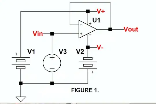

There are two problems here, I couldn't get a user defined function to work in the graph. The other one is your trying to make a function that passes in a parameter, when you can only use them to pass numerical information.
The other one is you can't reference a pin current anywhere but a graph, so if your using the colons, that won't work. The way to reference a pin current is described in a few answers like this one. The short answer is if you want to reference a pin current is with a zero ohm resistor or 0V voltage source and then measuring the current (ie: for a resistor called R2, you can do this I(R2), but not this I(R2:1))
You can't use use user defined functions graphically, you can use them in b sources and other areas in the spice file. If the need arises where a function needs to be graphed, use a b-source to convert the function to data that can be graphed. Inconvenient, but that's the way it is, and is unlikely to change do to the way LT spice works.

  • Ok thanks, i was afraid of this.... So i could just put in my subcircuit a ".func A() ..... " and attach a behavioral source that implements the function, then plot the voltage at the output of this source? – Alessandro Russo Jul 23 '18 at 16:01
  • Yep, just like in the picture. However, if your trying to reference a pin current see the edit. https://meta.stackexchange.com/questions/126180/is-it-acceptable-to-write-a-thank-you-in-a-comment – Voltage Spike Jul 23 '18 at 16:11
