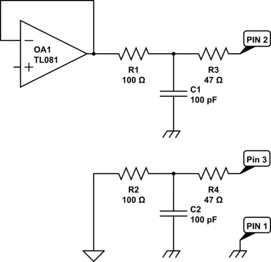

140kHz is actually reasonable, you want to be way above 20kHz to minimize in band phase shifts, and yes those opamps are drawn with the inverting and non inverting pins swapped.
However, there is a much simpler way to get most of the goodness, just make the source impedance to ground of the cold pin equal to that of the hot pin, but don't bother to drive the cold pin! A singled ended output stage plus 1 resistor and a cap gets you line balance that is as good as the complicated way, with 6dB lower maximum output as the tradeoff, but it still balances and you still get the interference rejection at the receiver.
Note that the line balance depends on how closely the resistors (and at high frequency the caps) are matched, 1% = -40dB worst case, 0.1% = -60dB worst case. The caps should be taken directly to chassis as should pin 1 via the shortest possible route, and the earthy end of R2 should probably connect to circuit reference at the decoupling caps for the opamp. Circuit reference and chassis ground should be connected at ONE point.

  • This could do with a schematic, Dan, to clarify what you mean by "hot" and "cold" as well as showing how a single-ended output could give a balanced output. – Transistor Jul 15 '18 at 12:48
  • I think I understand what your proposed circuit is doing but I always understood "balanced" to mean a push-pull arrangement. What is your definition? Would you not set OA1's gain to +6 dB to counteract the loss in this design? – Transistor Jul 15 '18 at 15:22
  • Nope, balanced refers strictly to matching the common mode impedance to ground, differential is the term you are thinking of. +6dB is fine if your output buffer has the required voltage headroom, but usually you are pretty close to banging off the rails at full shout anyway. – Dan Mills Jul 15 '18 at 15:58
