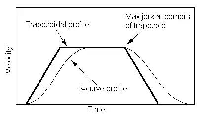

What you're looking for is called a Trapezoidal velocity profile.
There is no need to use sin waves. Smooth motion can be achieved by simply linearly ramping up the velocity to its maximum, holding it there, then letting it ramp down again. Many CNC milling machines and robots use this type of profile.
If you want super smooth motion, you can go for an S-Curve profile.
S-Curve profile
The maths for this is considerably harder, but the motion is beautiful. In this video they show how the two motion profiles affect a glass of water.

  • wow, yeah, it is exactly what i was looking for. do you have also some links for implementation? – nkint Aug 23 '12 at 08:04
  • I really,really doubt that video is showing trapezoidal velocity vs s-curve velocity. It looks like no acceleration at all vs linear acceleration. – Connor Wolf Nov 13 '12 at 09:43
  • The thing I think they mean is that a linear *acceleration* profile produces a s-curved *displacement* profile. – Connor Wolf Nov 13 '12 at 09:44
  • @FakeName - Yeah, now that I watch it again, it's hard to see any acceleration going on. It might be that the acceleration phase is so short that it's impossible to detect in the video. In which case it's not really a fair test either. – Rocketmagnet Nov 13 '12 at 10:32
  • @Rocketmagnet - Oh, I certainly see *acceleration*, but I don't see *ramped* acceleration. It looks like straight-up linear acceleration to me. – Connor Wolf Nov 14 '12 at 02:40
