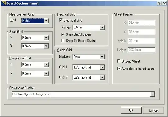

Since the component is specified in mm in the datasheet, switch to metric units. Press 'O' 'B' to bring up the board options. Switch to metric

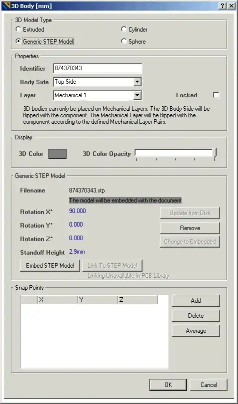

Now to place the 3D model. Press 'P' 'B' (for Place Body). Click 'Generic STEP Model', then 'Embed STEP Model' and select the file. Set the X rotation to 90º and the Standoff height to 2.9mm.
Place Body
Click OK, and place the model on the document. Now drag the purple rectangle by the middle of its lower edge, and snap it to the origin.

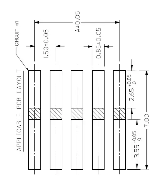

Now to place the pads. According to the datasheet, the pads for the connector are 0.85mm x 7.00mm, and are placed 1.50mm apart.

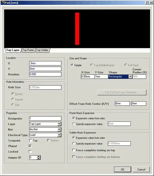

Press 'P' 'P' (for Place Pad), then press 'Tab' to bring up the pad options.
Set the X and Y size of the pad, and make it rectangular. Set the Designator to 1, and the Layer to Top Layer. Click OK.
Pad options

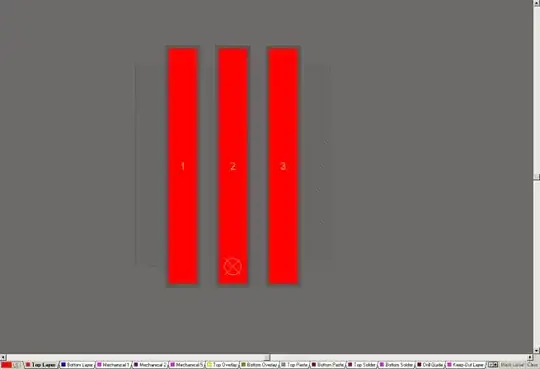

Now place the three pads on the document. Do the left one first (at -1.5, 3.0), then the middle one (at 0.0, 3.0), then the right one (at 1.5, 3.0). Right click to stop placing pads.
Placing pads

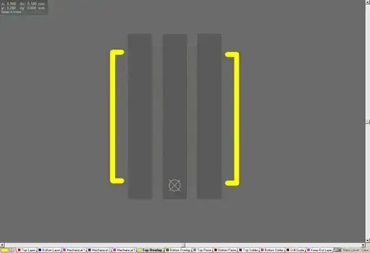

Go back into 2D mode '2' to place the silk screen. Switch to the Top Overlay layer, and press 'P' 'L' (for Place Line). Press 'Tab' to set the options, and set it to 0.2mm. Draw in some lines to give an indication of the part size. Don't draw them over the pads.
Silk screen

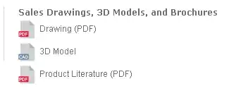

Follow the link you posted.
Then click through to the PDF sales drawing. In the upper center you'll see the recommended footprint. It's just one rectangular pad for each pin of the connector (I think 3 in your case).
In Altium, create a new footprint. Give it a reasonable name.
Use a 0.5 mm grid to make it easier to place your pads.
Add 3 rectangular pads with the dimensions given in the Molex drawing. Place them in a row spaced 1.5 mm center to center, as shown in the drawing. Make sure they're numbered 1, 2, and 3, in the correct order. You might want to put pin 1 at location 0,0 or you might want to put the middle pin at 0,0, whichever you prefer.
