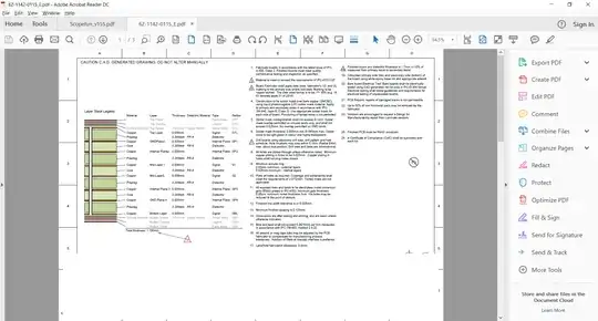

Last but not least: the documentation pack. When I send a design out, the pack contains literally everything necessary to produce the design. This includes a master assembly drawing, a master PCB fabrication drawing (which contains information not in the gerber / ODB++ electronic data), drill drawings, test requirements, test methods with pass fail criteria, schematics (if you want the CEM to troubleshoot failed items), full production BoM (with all non populated parts removed).
Clearly, gerber / ODB++ data is sent as well (all the stuff necessary for the fabrication to be done). ODB++ is the preferred method for the better assemblers as of 2018.
My master assembly print also lists the identifiers of not fitted parts as they are usually still in the pick and place file (there are ways of ensuring they are not depending on the CAD tool used); if they are still in there, it is difficult for the CEM, so you need to help them out.
The documentation I provide meets IPC-D-325 incidentally.
I am not going to even get into export regulations.
Here is a (slightly redacted) fabrication master front page (page 1 of 3):
Fabrication Master drawing
