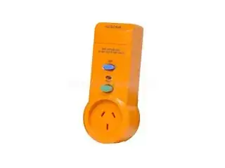

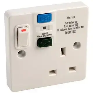

The plug-through Earth Leakage / Residual Current (ELCB/RCD) devices just happen to do this.
You have to press RESET/ON to latch them on after a power cut. They do this, because they happen to use a self-latching relay arrangement (as described by Marcus) It also happens to be an RCD, but you don't care about that.
Note this behaviour is generic to RCD's that have the RESET and TEST buttons. So the wall socket versions also do exactly what you want
Henry Crun
  • 5,273
  • Why would this device trip in a power cut? ELCB/RCD require an L-N current imbalance to unlatch the sprung switch. A power cut will not create this condition. – Transistor Jul 13 '18 at 14:13
  • I'm in Ireland so I won't find that brand. Seems odd though. – Transistor Jul 13 '18 at 14:18
  • Not especially odd. You wouldn't want it to automatically come back on , when there was faulty equipment. Since it lacks the special mechanical mechanism an mcb has, this is an easy way to be latched out. (they are not an electromechanical EL circuit breaker). It's generic behaviour – Henry Crun Jul 13 '18 at 14:22
  • Henry, thanks for answering to my question but this device is not what i need. This device is more like a mcb, it breaks circuit when it detects higher voltage across it. But what i need is a circuit breaker that breaks circuit when there is power outage and keeps breaking circuit when power comes back until i switch on the circuit breaker. – Anshuman Jul 13 '18 at 20:13
  • @APS Would you like a nice tummy rub with that too? `In today's online world it is not necessary to see a device, one can get all information just by its name.` Apparently you can't. Might want to check out meatspace for some authentic experience. Its great, if a bit slow moving, I recommend it – Henry Crun Jul 13 '18 at 22:58
