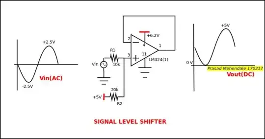

It isn't needed, if an op amp is in the inverting configuration signals beyond the rails can be used. Take for example this circuit:
A negative voltage can be shifted up with a single supply op amp. They also have 'beyond the rails' op amps that extend slightly ( ~300mV ) beyond the rails to allow for a slightly larger range, of course the output limit still applies.
