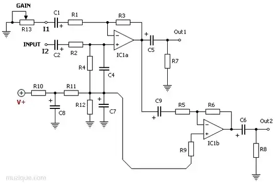

Example: Input = Audio Signal (1.2V pk-pk) VDD = 4.8V VSS = GND enter image description here
VCM - Upper limit = 4.8-1.2 = 3.6
VCM - Lower limit = 0-0.3 = -0.3
VCM - \$V_{CM_{PP}}\$ = 3.6-(-0.3) = 3.9V
\$V_{IN}\$ - Positive Cycle of input = 600mV + (VDD/2) = 3
\$V_{IN}\$ - Negative Cycle of input = -600mV + (VDD/2) = 1.8
\$V_{IN}\$ = 1.2Vpk-pk
Meaning the input Vpk-pk is suitable?

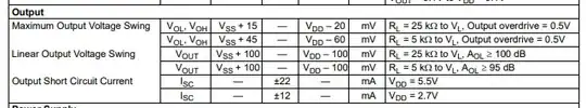

VOM: Output Voltage Swing
Here is what I understand - Its the range of which the MCP601 is capable of outputting before clipping.
Example: Input = Audio Signal (1.2V pk-pk) VDD = 4.8V VSS = GND GAIN = 3.2
Input Bias = VDD/2 RL = 5k
VOM - Upper limit = 0+100mV = 100mV
VOM - Lower limit = 4.8-100mV = 4.7V
VOM - \$V_{OM_{PP}}\$ = 4.7-100mV = 4.6V
\$V_o\$ - Positive Cycle of input = (3.2*600mV)+(VDD/2) = 4.32V
\$V_o\$ - Negative Cycle of input = (3.2*-600mV)+(VDD/2) = 0.48V
\$V_o\$ - \$V_{o_{PP}}\$ = (4.32-0.48) = 3.84V (Before decoupling Cap).
This is how I understood to calculate for both \$V_{CM}\$ and \$V_{OM}\$. To me this OP-AMP shouldn't have a problem with the Vin as well as happily amplifying the Vin as well, however the opposite happened as it clips at 2.84Vpp. This doesn't make much sense to me from the calculation above. The VCM should be satisfied as well as the VOM. As the VOM has a Vpp of 4.6V which is > then my Vo of ideally 3.84Vpp and my VDD being 4.8V it should amplify to 3.84Vpp no problem?
If anyone can show me how to actually calculate VCM and VOM that would be amazing, I believe this method is missing something or I am not understanding some fundamental logic. I would like to gain the ability to understand input and output limitations through this method.
This configuration works if I increase VDD to ~6.1V if anyone can explain why through the VCM and VOM calculations I can probably correlate the two and probably will clear up any confusions I had.

Your 2nd datasheet snip is in mV not volts, and the output range is relative to the supply voltages. So with a 4.8V supply and 5K load (to 0V) the linear output range is 0.1 to 4.7V. If you bias the input and output at 2.4V you can get 4.6Vp-p. The op-amp output cannot exceed (or even meet) the supply voltages.
If the input is biased at 2.4V, your input range is -0.3 to 3.6V so you can only handle an input voltage of 2.4Vp-p = (3.6-2.4V)*2, based on the input range, however you also need to make sure the output does not saturate.
Your circuit has a gain of +3.2 so input voltage has to be within the range of +/-0.71875V or 1.4375Vp-p, which will yield the full output range, so the input range is not limiting.
You can use pretty much any op-amp on a single power supply provided you have enough supply voltage and provided you bias the input within the working range and provided you keep in mind the available output range.
In general for a low power circuit you would want to use higher value resistors than you show. You are loading the output with 5K||(2.2K+1K) which is lower than 5K, obviously, so the output swing is not guaranteed. Normally you can go at least 10x higher for the feedback resistors, maybe considerably more. If you can increase the load to 25K or 100K, and increase the feedback resistors by 100:1 it would be better. You may have to add a small capacitor across R3 to assure stability if you go very high with the resistors.
Spehro Pefhany
  • 376,485
  • 842
    Sorry about that completely missed the mV, fixed it. Sorry, once again :/ I dont understand how you came to 2.4Vp-p for some reason it makes sense that my input is 1.2Vp-p as its shown above, did I make a mistake in the calculations? – Leoc Jul 11 '18 at 03:22
  • Your output will saturate before the input causes trouble but with the input biased at 2.4V you can go *down* to below 0V but on the high side you can only go to 3.6V so that is the limiting number (through the capacitor it will be centered at 2.4V) 3.6V - 2.4V is 1.2V. So +1.2V relative to 2.4V. The input can go negative (relative to 2.4V by more than 2.4V but that doesn't matter). Anyway, the input is not limiting, the output is limiting with a gain of 3.2, and mid-supply (2.4V in this case) is the optimal bias because the output range is centered around the middle of the supply voltage. – Spehro Pefhany Jul 11 '18 at 03:27
  • I still don't understand the output is limited, based on the calculations Vom: -0.1V < Vo < 4.7V Vo: 0.48 < Vo < 4.32V this is at the output of the op amp, unless when you decouple it thats the problem? – Leoc Jul 11 '18 at 03:36
  • The linear output range with a 4.8V supply is +0.1V to +4.7V with a specified load of 5K. It would be better to have a load of 25K or more. Your load is less than 5K so output swing may be less than specified. – Spehro Pefhany Jul 11 '18 at 03:40
  • I have tried using a 1M and it still clips? – Leoc Jul 11 '18 at 03:43
  • You need to increase R3, R4, R5 – Spehro Pefhany Jul 11 '18 at 03:46
  • I see I see, however whats actually happening. Why is that when I pick a RL that isnt good and my output voltage just gets shot? – Leoc Jul 11 '18 at 03:47
  • It's a low power op-amp, it can only drive so much current. – Spehro Pefhany Jul 11 '18 at 03:49
  • I see I see, you can find any resistor value using the OP AMPS max current out with ohms law right? Can we rewind back a little? I am still confused about VCM and VOM. I am understanding the VCM, however the VOM is little bit wonky. If my range of VOM is : -0.1 – Leoc Jul 11 '18 at 03:54
  • Yes but 100mV drop is defined with load at 2.5V and your load starts at 0V with the output cap charging up. Your load is also 2.2k//5k – Tony Stewart EE75 Jul 11 '18 at 04:02
  • Would makes a RL ~ 1.5k, right? I should try a value that makes the parallel of R2 into 5k or higher. However in the linear output swing it looks like it doesnt matter of the resistor value as its the same headroom from 25k to 5k – Leoc Jul 11 '18 at 04:30
  • I forgot to mention when increasing VDD to ~6.1V it fixes everything – Leoc Jul 11 '18 at 04:38
  • Also forgot to mention, Changing the resistor feedback wont be viable as I am using a digi pot as R2 so learning how to read VCM and VOM will be more viable as I probably need a new OP AMP – Leoc Jul 11 '18 at 04:46
  • and when you say 5K||(2.2K+1K) are you assuming C3 is a short? – Leoc Jul 11 '18 at 08:15
I believe I figured out the conundrum.
Taking up a project such as this and using op-amps to this extent, such as looking for characteristics you wouldn't usually look for coming out of university as input bias current, Vom, Vcm, etc.
Trying to joggle all these terms tend to confuse me and kinda overwrite the basic things I knew about op-amps.
When I was first introduced \$V_{OM}\$ and \$V_{CM}\$ for some reason I made myself believe as if the \$V_{in}\$ and \$V_{out}\$ didn't violate the \$V_{OM}\$ and \$V_{CM}\$ then clipping shouldn't exist. THIS IS completely WRONG
What I didn't account for is the voltage drop that the op-amp has internally due to it's architecture of the op-amp.
Meaning no op-amp can go rail-to-rail unless its perfect (no voltage drop in the internals).
For the problem above is a single power supply non-inverting amplifier, which means it requires a bias in order to swing "negative"
For Reference:
thus, its 4.576V -- 2.288V -- 0V
\$V_{DD_{pp}}\$ = 4.576V \$V_{DD_{p}}\$ = 2.288V
Through experiments, I found the voltage drop of the amplifier to be around ~1.616Vpp
We will do 2 case scenarios Where,
input_1 = 860mVpp
Input_2 = 1.14Vpp
Gain = 3.2
Input_1: 860mVpp
VCM:
-0.3 < \$V_{IN}\$ < 3.376
Vin:
1.858 < \$V_{IN}\$ < 2.718
Vin is within range of Vcm
VOM:
-15.424 < \$V_{OUT}\$ < 15
0.912 < \$V_{OUT}\$ < 3.664
Vo is within range of Vcm
You would expect your signal to behave as you predicted.
Input_2: 1.14Vpp
VCM:
Vin:
1.658 < \$V_{IN}\$ < 2.798
VOM:
0.404 < \$V_{OUT}\$ < 4.052
You would expect your signal to behave as you predicted, however it isn't.
On my oscilloscope it clips at 2.96Vpp but we expected the output to be 1.14Vpp * 3.2 = 3.648Vpp? What is happening is the Voltage drop of the op-amp.
As mentioned above the voltage drop of the op-amp was ~1.616Vpp so doing the math in-tales
VDD -Vod = 4.576 - 1.616 = 2.96Vpp !! This essentially is telling us what our op-amp can actually drive up to. Which all makes sense now.
Essentially what an op-amp says rail - to - rail it means at least what I can see is that your Vin and Vout will never usually violate the op-amps VOM and VCM's
This is why when I increase VDD ~6.1V it works as the op amp can actually drive up to the expected output of 3.648Vpp as follow:
Vdd - Vod = 6.1 - 1.616 = 4.484 as the op-amp new limit is now 4.484Vpp and since 3.648Vpp < 4.484Vpp you can see it on the output.
