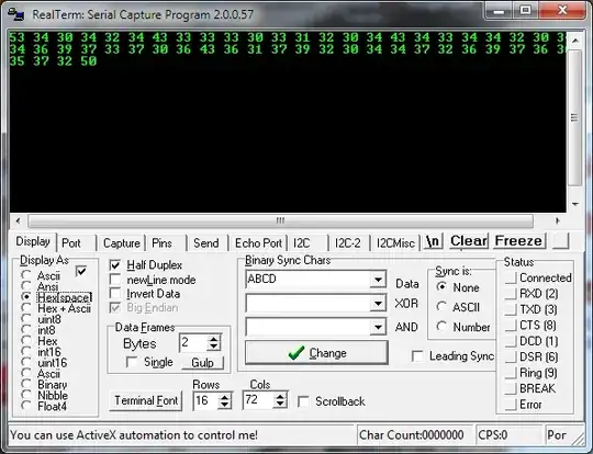

My personal favourite terminal emulator for debugging is RealTerm which has a nice range of display options for embedded systems. Both RS-232 and TCP/IP operate fine under Windows 7 x64 and below (I haven't tried under Win 8 but don't have any reason to think it wouldn't work). A few features I find especially useful are:
  • ASCII / HEX view of data
  • Capture files can include timestamps
  • There's an easy way to send binary data sequences
  • Hardware flow control pins can easily be monitored / changed
There are also quite a few other options for I2C, SPI, Dallas 1-wire and GPIB. I haven't personally used those features but there's a good summary on the SourceForge page above. Here's a screen capture of the main display tab view:
