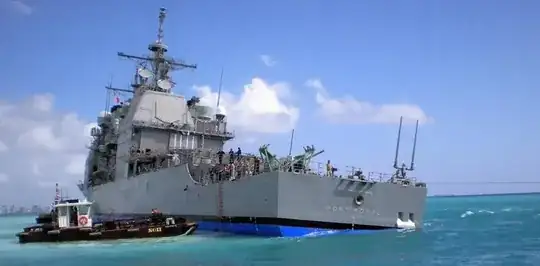

According to the above page, here are people who didn't do it properly - USS Port Royal grounding in 2009. However, according to Wikipedia report it was not a compass error but a more high tech navigation system error followed by lots of human error that lead to the grounding. I'll leave the picture as it does make the point of what can happen if your navigation system is faulty. Just stay away from coral reefs with your car! :-). (Reef cost them $15M to repair. Ship between $25M & $40M)
