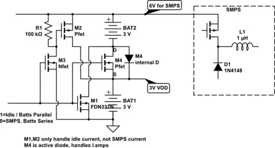

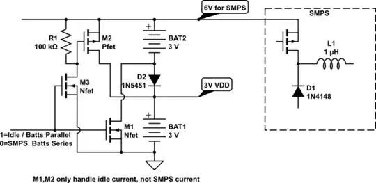

As a matter of interest, here is series/parallel switching arrangement to deal with the unbalancing of batteries where there is a long, low current drain at 3V, and an high current drain at 6V.
As the ration of idle/sensor energy to transmitter energy increases, at some point this becomes economic.
D2 is a schottky and does carry Ismps, losing power, but more importantly worsening the dropout voltage. It can be replaced by a pfet active diode (note D,S)
simulate this circuit
A small dpdt relay is also an option, but you have watch the capacitors carefully. If there is a splat as the relay connects capacitors, the contacts will die quickly.

  • Thanks for the circuit suggestions, on my next version I will probably be using an ultra-low-power buck converter to get the 3.3V from the 4 series cells so they are all discharged evenly – Andres Jun 26 '18 at 02:39
  • If your sensor task can run from the 2.4V minimum of 2 cells, then this is lower (zero) power, cheaper, simpler, and not single-source than a micropower step down. If your sensor can do sleep task on 2.4V, but needs (say) 3.3V for the sensor task, then it can be very energy efficient (and cheap) to use a step-up that you only turn on for the duration of the task that needs the extra volts. – Henry Crun Jun 26 '18 at 06:34
