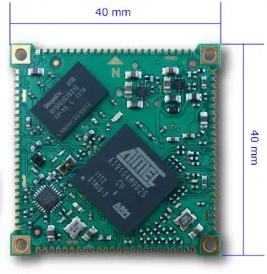

ARIA ARM9 SoM
A very similar product to the Raspberry Pi but runs on an ARM architecture that is fully supported by many Linux distributions. The nice thing about this is that you make the rest of the circuit- SO you can embedd a 2GB flash and run your own build of linux with API's on it while offering LAN, SPI, GPIO,I2C etc.
Aria G25 is a small SoM (System-on-Module) thought of for hardware designers who want to reduce the development time of OEM Linux embedded devices. Aria G25 can be used either as a SMD module on a PCB or as stand-alone module to wire directly to other modules.
  • ARM9 @ 400Mhz
  • 128 or 255 ram
  • USB and LAN
  • 0.3 watt power consumption
  • 24 Euro's
  • Fully expendable for you design!
