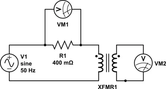

I am trying to measure the magnetic hysteresis curve of a toroidal nanocrystalline ferromagnetic transformer core made of Nanoperm (datasheet linked) using the following circuit. Each of the windings (primary on input side and secondary on measurement side) has 6 turns of 16 AWG magnet wire. The 1 micro-F capacitor on the output side is used because when the magnetic field saturates, the output current goes to zero. Thus, with just an RL circuit on the measurement side, the voltage drop across both the coil and the 5 kOhm resistor are zero during saturation. The capacitor essentially holds the saturation voltage until the polarity of the input is reversed.
I justified my method first intuitively and later confirmed that it more or less matched with the method shown here (section title: "Measuring arrangement with an analog oscilloscope"). The only difference is that rather than directly connecting the function generator to the primary coil and using an op-amp integrator circuit on the measurement side, I use an audio amplifier (not shown) to amplify the current of the function generator to approximately 5.3 A (= 2.1 V / 0.4 ohms) and use a passive integrator on the measurement side.

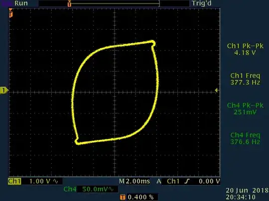

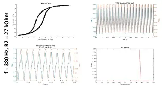

An image of the hysteresis curved as measured on my oscilloscope is shown below. VM1 is plotted on the horizontal axis, and VM2 is plotted on the vertical axis.
Based on this information, how can I calculate (Q1-1) the magnetic field strength (in A/m) applied to and (Q1-2) the magnetic flux density (in T) induced in the core up to and during saturation?

The table below summarizes the cutoff frequencies and gains for input frequencies of 350 and 50 Hz, which were used in these experiments: enter image description here

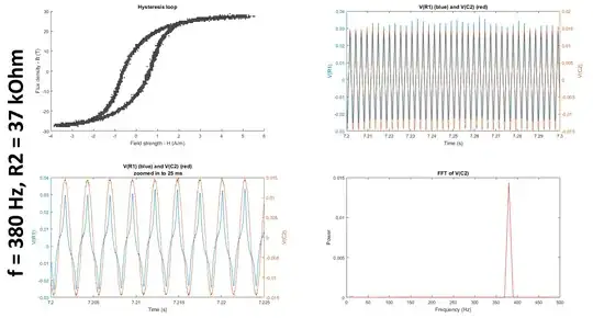

The figures below summarize the results of twelve experiments: \$f = \{50, 350, 380\}\$ Hz \$\times\$ \$R_2 = \{5, 10, 27, 37\}\$ kOhms. Each figure contains four subplots: a hysteresis loop, a plot of the voltage across R1 and the voltage across C2 against time, another plot of the previous but zoomed in, and a plot of the Fourier transform of the voltage across C2.
enter image description here enter image description here enter image description here enter image description here enter image description here enter image description here enter image description here enter image description here enter image description here enter image description here enter image description here enter image description here
Note that to make my hysteresis loop more comparable to those in the datasheets linked above, I converted the raw voltages measured by my probes to magnetic field strength H (units of A/m) and magnetic flux density (units of T) using equations given in the tutorial linked above: $$H \equiv \frac{V_R(t)\cdot N}{R\cdot l_c}$$ where \$V_R\$ is the voltage across the resistor, \$N=6\$ is the number of turns, \$R = 400 \mbox{m}\Omega\$ is the shunt resistor connected to the audio amplifier, and \$l_c = 10.03 \mbox{ cm}\$ is the magnetic path length given here; and $$B(t) \equiv \int_{0}^t{\frac{E(t)}{-N\cdot A_c} dt}$$ where \$E\$ is the electromotive force (EMF) induced in the secondary winding, \$N=6\$ is the number of turns, and \$A_c = 0.88 \mbox{ cm}^2\$ is the cross-sectional area of the core given here. The raw voltages are plotted in the second and third subplots of each figure.
The MATLAB code used to generate H and B from the measurements is shown below:

where V(:, 1) and V(:, 2) correspond to the most recent 100 ms of data acquired by the differential probes VM1 and VM2 in the circuit diagram above. I think V(:, 2) already accounts for the integration since it is the voltage across the capacitor on the measurement side, but (Q2-3) I may be missing a multiplication by time in my calculation for B since the units for B are Teslas, which expressed in more fundamental units are \$\frac{V\cdot s}{m^2}\$. It would be great if someone could confirm this / correct me.
The shape of my hysteresis loop looks nowhere that of the hysteresis loop given in either of the datasheets here (page 3) or here even though both report measuring the hysteresis at 50 Hz. (Q2-4) Does anyone why this is the case?
Furthermore, other than H for the 50 Hz input cases, both H and B are orders of magnitude off compared to the values reported in the two datasheets. (Q2-5) Is this something due to the way I'm calculating H and B or due to the circuitry itself? Does this have anything to do with the fact that the integrator has a gain of much less than 1 for the frequencies I'm looking at?

I don't recognize your method but I'm not ruling out that it has some merit but the oscilloscope trace doesn't look right to me. If you want the details of the material used just get hold of the data sheet for the nanoperm material. Extract: -
The hysteresis plot you want is the one in blue I believe.
With 6 turns, the MMF is current applied x 6 turns. To calculate H just divide the MMF by the mean magnetic length of the toroid. That can be calculated as the mean diameter (23 mm) times \$\pi\$ = 0.072 mm.
So if your current is 100 mA, the H field is 0.6/0.072 = 8.3 At/m and this would produce a flux density of about 1 tesla

I first modified my circuit by placing VM2 directly across terminals of the secondary coil, as shown in the circuit diagram below.
The voltage induced in the secondary coil is what would have been integrated by the RC integrator (or op-amp integrator). Rather than integrating this voltage with hardware, I integrated the voltage in MATLAB using the cumtrapz function. MATLAB code to generate the hysteresis curve (including the integration) is given here:
