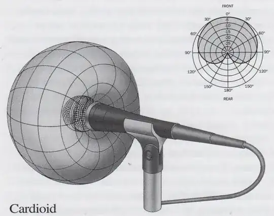

  • Directivity - how the angle of sound affects the response. Different types of microphone have different patterns. This is affected by both type of element (dynamic, condenser, ribbon, etc) and case design:
Here the direction response patterns (known as polar patterns) for a typical cardioid (left) and shotgun mic (right)
cardioid polar shotgun polar
Usually they are given in 2D, but for those new to them it may be easier to understand if we can see a 3D representation - here is the same cardioid pattern in 3D:
3D cardioid
From these we can see that e.g. if you need to only pick up sound from a specific direction then the shotgun is a good microphone to use.

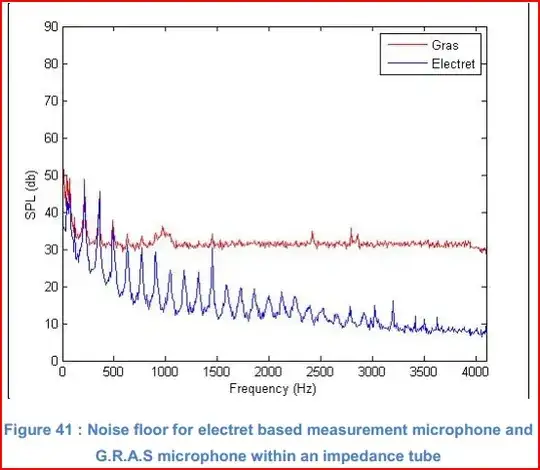

  • Price - as with many other things in audio, this is not always dictated by performance. A cheap electret capsule (~£1) when biased properly can have much better frequency response than e.g. an old valve condenser mic that could be hundreds. Here (from Elliott Sound Products) is a discussion and example of using a cheap electret capsule (often maligned, but this is usually due to poor design rather than the capsule itself) to make a test microphone with performance comparable to professional models.
    For an even more detailed and excellent discussion, this thesis compares a test mic built with a ~£1 electret capsule (total cost around £15) with a pro mic setup costing ~£500. The cheap mic outperforms or matches the pro mic in most areas. For example, here is the noise floor for both mics:
Noise floor comparison
