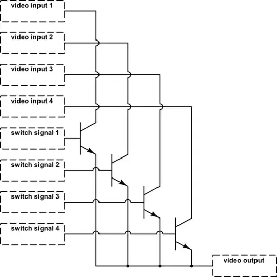

After hours of searching, my crude solution was below.
  • transistors used for switching
  • Arduino analog port used for switch signals
  • a momentary switch is connected to Arduino. You push the switch to cycle through video input signals (e.g. input1 -> input2 -> input3 -> input4 -> input1 -> ... for each push)
  • only one transistor is "turned on" at a time. When you want to switch to other inputs, all the switch signals are turned off then the target switch is turned on.
  • The grounds of the inputs, switch signals and output are the same.

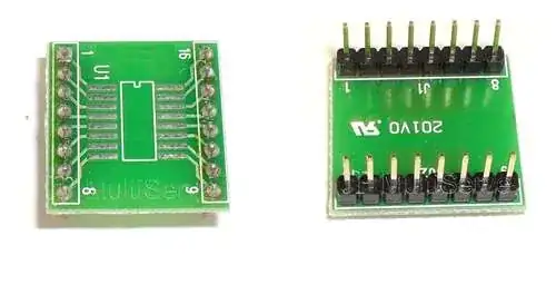

EDIT: Since this is a SMD IC, consider about using an adapter PCB (search for "breakout board") like this, for an easier soldering of the final PCB:breakout board for SMD IC
