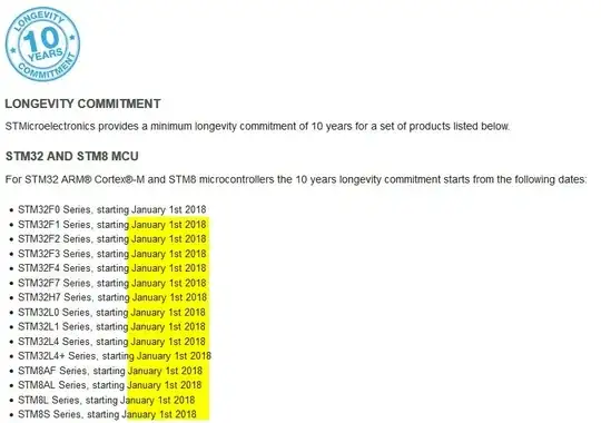

Below are just examples where i could easily find about longevity promises (ofcourse with *) i also see this as an hint on vendors i would prefer. Why would one choose from the vendor who has no such programs unless there is a huge record of not making parts obsolete? isn't it?
NXP
Link here
Renesas
Link here enter image description here
Si Labs
Link here
STM32 Microcontrollers
