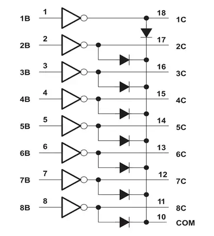

As @dim suggested, I have contacted the manufacturer and I have received an answer. The IC inside the Adam-4055 driving Digital Outputs is a ULN2803 (specs, info). The reason why they connect the D0.COM pin is to take advantage of the built-in the fly-back diodes.
ULN2803 Chipset
The Open Collector gate is a Darlington:
ULN2083 DO Schematic

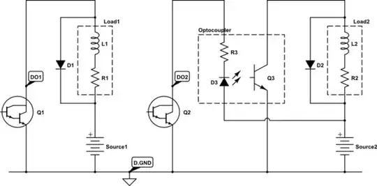

According to this new information, I think I can:
  • Share the D.GND pin among power sources;
  • Skip the D0.COM pin and miss the built-in fly-back diodes;
  • Use different power sources (within the IC specification);
  • Add additional fly-back diodes on inductive loads to protect the IC;
  • Add Optocoupler if I want to completely isolate loads from IC.
A possible setup is now (I may have not chosen the best symbols):
Now it is just about shipping compliant components provided they exist and are available. Thank you for your valuable feedback.

    Excellent. It makes sense, your solution is correct and you did well by answering your own question. – dim Jun 19 '18 at 10:28
