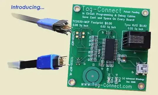

It's not an edge connector, but it sounds like what you need is a Tag Connect cable:
Tag-Connect cable
They're cables with alignment and spring-loaded pins in the end. On your PCB, you just need an extremely small footprint -- no BOM parts. There are versions with "no legs" (very small), and versions with "legs" (which clip into the board to hold it securely in place). The TC-2050 version has 10 pins. I use them for programming all of my boards these days.

  • Very nice! So where can I buy them like in EU (where do you buy them from?) – Piotr Kula Aug 15 '12 at 14:43
  • [FindChips](http://www.findchips.com/avail?part=tc2030) might help. The 6-pin version (TC2030) is in stock in a bunch of places, but the 10-pin version [only seems available](http://www.findchips.com/avail?part=tc2050idc) at DigiKey, which does [ship to Europe](http://www.digikey.com/us/en/international/europe.html). – Jim Paris Aug 15 '12 at 14:51
  • Nope! But you only need one, if you're just using it for initial programming or debugging. – Jim Paris Aug 15 '12 at 14:56
    Wow, 35 dollar! "Not cheap" may well be the Understatement of the Year :) – Federico Russo Aug 15 '12 at 15:01
    Depends on your point of view. How much did your development and programming hardware cost? What's your time worth? For any serious project, a NRE like this is trivial. – Jim Paris Aug 15 '12 at 15:59
  • I really like that and will buy it some time. It is an excellent alternative answer and I wish I could give you more points but that is up to the community now. Thanks. – Piotr Kula Aug 15 '12 at 17:29
  • In the end I used only the tag connect with out an edge connector- The edge design was starting to annoy me; there is a ready eagle library I used in a few minutes. Even though your answer helped me- the point steven made that almost no edge connector was good for my use case(based on my question) so his answer is still the best. Thanks any allot for this anyway! – Piotr Kula Aug 30 '12 at 21:51
