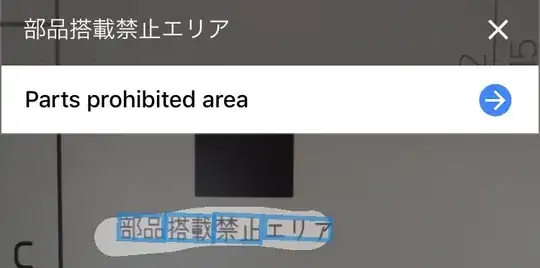

Google translate on your phone can do this:
  • Parts prohibited area (部品搭軾禁止エリア)
  • Pattern prohibited area (パターン禁止エリア)
  • Soldering prohibited area (半田付け禁止エリア)

    So in other words: "Keepout"... – brhans Jun 14 '18 at 14:19

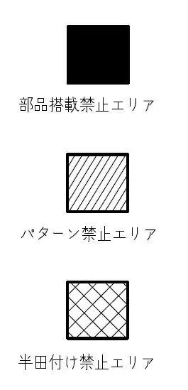

Disclaimer: I am clueless about EE, but read Japanese well enough to look this up.
Black box: 部品搭載禁止エリア = "components/parts-loading prohibited area" (don't put stuff here, I assume).
Diagonal lines: パターン禁止エリア = "Pattern prohibited area" (I don't know what "pattern" refers to in this context, but don't do it there).
Diamond box: 半田付け禁止エリア = "solder-attaching prohibited area" (don't solder anything here). 半田 (handa) is "solder" in case you see that elsewhere.

    "Pattern" possibly "traces?" – JRE Jun 14 '18 at 16:27
    @AliChen Thanks for the correction, you correct! It seems likely to me the word "pattern" here refers to the [land pattern](https://en.wikipedia.org/wiki/Footprint_(electronics)) aka the footprint. [This spec sheet](https://www.marutsu.co.jp/contents/shop/marutsu/datasheet/UX60A-MB-5ST.pdf), for instance, refers to it both as パータン and ランドパターン. – undercat Jun 15 '18 at 02:18

In this micro-SD socket the spring contacts are located at the bottom of footprint, and during card insertion they may touch the PCB surface. Therefore there is a chance that PCB protective layer will be compromised over time, and the contacts will touch traces, if any. Therefore the manufacturer recommends to leave the shaded area without routing any signal traces or ground pours.
The black area is around the insertion detect contact, which moves sideways, so keep other components out of that area.
