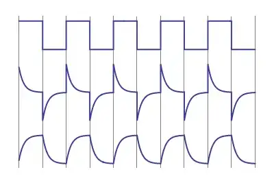

The negative voltage is a bit unexpected if you know that there isn't a negative supply. But it makes sense when we look at the voltage across the capacitor. When power is first applied the voltage on both sides of the capacitor is zero. We start the square wave, and the input goes to 5 V. Capacitors are reluctant to have fast voltage changes across them. You'll have to supply a lot of current to charge them fast. But the resistor doesn't allow this, so what initially happens is that the right side of the capacitor just follows the input; it also jumps to +5 V, and then slowly gets charged through the resistor. (Note that charging here means decreasing the voltage, since the voltage at the input is positive.)
When the input goes to zero something similar happens. Again the output will follow the input because the voltage won't change that fast. But the input was at 5 V and the output at 0 V. So when the input dives to zero, and the capacitor will maintain the 5 V across it the output has to go to - 5 V.
I've added a third curve to your drawing. The top one is input, the middle one is output, and the bottom one is the difference between those, i.e. the voltage across the capacitor. You can see that it follows the familiar charge-discharge pattern, without fast voltage changes.
end of edit
The lowering voltage(*) is due to the resistor. It will exponentially draw the output voltage down at a rate determined by the time constant RC. After 1 RC time the voltage will have dropped to 37 % (1/e), after about 5 RC times to 1 % (rule of thumb).

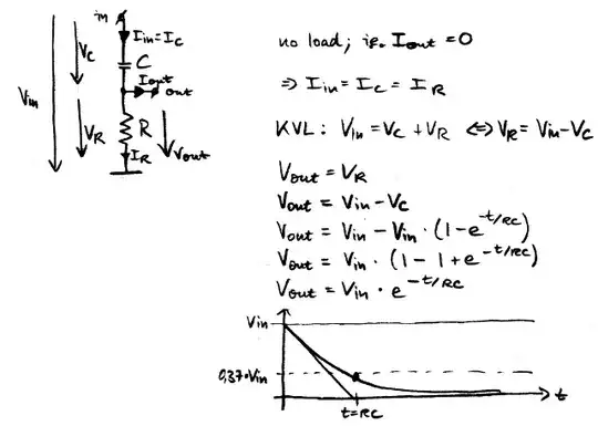

Here's your original circuit again, with some symbols we will need for the explanation, the assumption that we have no load, and the equations showing Vout  for C on top and R at the bottom.
RC differentiator
We can imagine how the upper plate of C remains at Vin, the lower plate becomes charged towards 0 V, and finally, there is no voltage left across the resistor, between the lower plate and 0 V.
This finally answers the first part of your question (Why is C discharged?) - It is not discharged, it really is charged; we're just not looking at the upper plate, but at the lower plate connected to the resistor, gradually being pulled low through R.
Now, let's remember that the output voltage is equal to the voltage across the resistor. Vout = VR = R × IR, and again, assuming that Iout = 0 (negligible load), Vout = R × IC. In other words, the output voltage is proportional to the charging current of the capacitor, scaled by the value of the resistor R.
A low-to-high step of the input signal will thus create a positive spike across R, as we have already calculated. When we reverse everything, we see how a high-to-low step will create a negative spike because the current through C is flowing in the opposite direction of the arrow we have used for IC - which answers the second part of your question ("Why do we get a negative spike at the output?").
